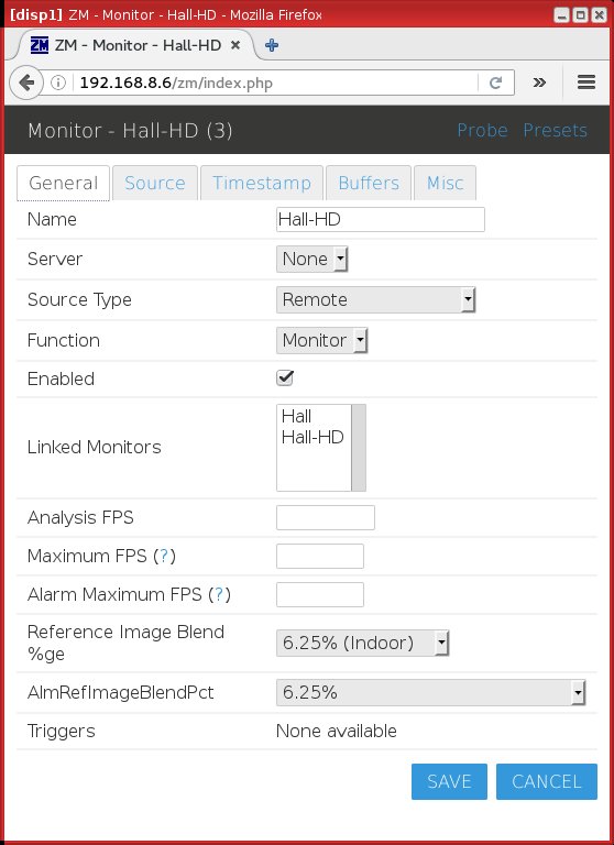

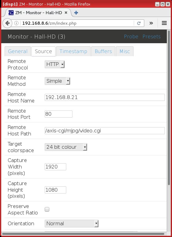

Edited to add screenshots:
General Tab
General Tab
Source Tab
Source Tab
