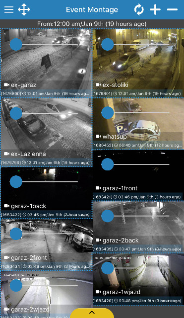

Unfortunately I have the same problem (on v1.30.0).
One might think it should be easy to solve because it worked beautifully already, but no.
I converted my zoneminder to two servers setup, and zmNinja showed me red question marks immediately.
Of course it did it at the end, when finally I got it right. Earlier when the two server zoneminder worked only partially and there were problems, zmNinja had none.
I have two servers:
seen from outside as
zm1.domain:66/zm
zm2.domain:67/zm
inside
zm1.private_domain:66/zm
zm2.private_domain:67/zm
in /etc/zm/zm.conf there are ZM_SERVER_HOST=zm1 and ZM_SERVER_HOST=zm2 respectively, both convert to proper (private) IPs.
And everything works: timeline, events - except montage.Montage doesn't work even inside, using the private addresses. Desktop version or mobile apps - no difference.
The paths are correct, I even tried /cgi-bin/zm, zmNinja said it was wrong.
Thanks for any tips...

It's hard to help without logs, but lets make sure I understand what your issue is
So zmNinja worked before, but after you converted to your 2 server setup it doesn't?
1. So images show up correctly in zmNinja for timeline and events ?
2. How about event montage?
3. How above live monitor streaming?
4. Does Montage work in ZoneMinder console ? (not zmNinja)
Finally,
look at your apache error and access logs when you are in zmNinja montage - what do you see?

Posts: 5
Joined: Mon Jan 09, 2017 2:53 pm
Re: ZMNinja-Red question marks
Post by .wm. »
Thanks for the fast response :)
Yes, the conversion did it.
timeline works, with pictures, with videos.
event montage works perfectly, showing videos and timelines.
montage, live streaming: red marks.
zoneminder (in Chromium) works perfectly, including montage and live streaming.
in logs many:
ERR [socket_sendto( /var/run/zm/zms-555592s.sock ) failed: No such file or directory]
WAR [file:// is not found in servers list.]
it seems only zmNinja generates them, ZoneMinder doesn't.
