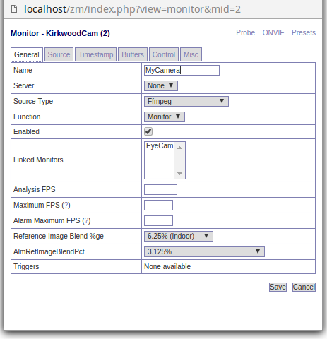

The purpose of me starting down this journey was almost two-fold. I needed to be able to control my DCS-5222LB camera from zoneminder, but under Zoneminder 1.26.5, the 'Control' options aren't available. So, in a quest to get the 'Control' console back, I upgraded from 1.26.5 to 1.30.0 using the Wiki Instructions for Zoneminder 1.30.0. My settings panel now looks like the attached image (WITH the control tab shown). Keep in mind, I did have to go into the Options, on the System tab, and turn on 'OPT_CONTROL'. In another article that I read, the variable was 'ZM_OPT_CONTROL'. So, I get the feeling that it might be different, but 'CONTROL' is likely going to be a part of the variable name.

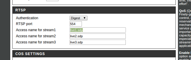

1) I noticed last time (zoneminder 1.26.5) that I was able to see the video feed, from my DCS-5222LB PTZ camera using RTSP. The settings I have are similar to the zoneminder wiki page, except I have the following:
** General Tab
Source Type: Ffmpeg
Function: Monitor
Enabled: Checked
** Source Tab
Source Path: rtsp://<username>:<password>@<camera ip address>/live1.sdp
Capture Width (pixles): 640
Capture Height (pixels): 480

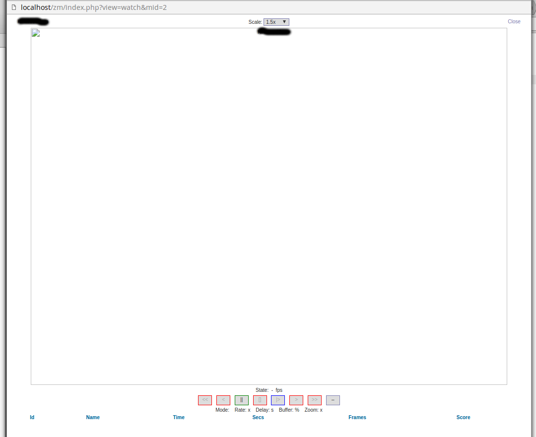

For some reason, the video feed has gone away and now all I see is the image attached. This is my new Problem #1.
