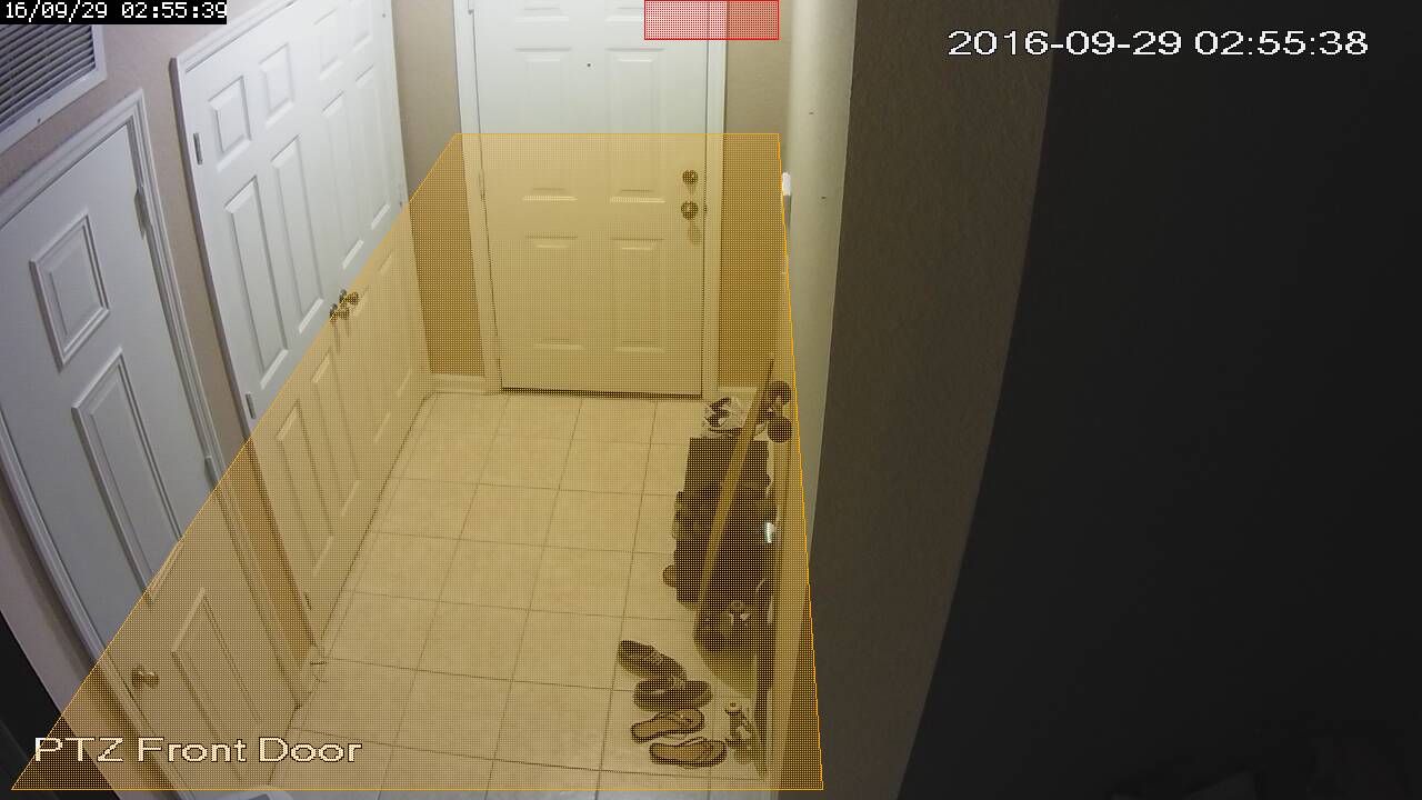

Hi all,
Setting up Zoneminder, I have a camera at the end of a hallway looking at the front door which has an "Active" zone covering the door and then an "Inclusive" zone covering the length of the entryway (See attachment):
Current zone setup
Current zone setup
I want the recordings to continue after the door is opened so long as movement is present in the "Inclusive" zone, but it seems like the "Inclusive" zone is just ignored (am I missing something about how Inclusive zones work?).
The "Active" zone works as intended, tripping once the door is opened, but the event recording stops while a person is still walking around in the "Inclusive" zone, which is very strange - the entirety of the event is just the "Post Event Image Count" after the initial "Active" zone is tripped and the "Inclusive" zone doesn't extend the recording, even though I am still walking around in that zone.
To test my settings, I changed the "Inclusive" zone to an "Active" zone - and it records as intended, as long as I walk around in the zone and then the correct "Post Event Image Count" after I leave the field of view. Unfortunately, I cannot keep it that way, as I don't want recordings to start unless the door has been moved first (preventing false alarms when walking into the camera's field of view, e.g. going into the closets, while the system is armed). I also don't want to simply put a long "Post Event Image Count," as I could end up missing activity of a true event.
Any help would be greatly appreciated - I already have some Python scripts I'm planning on tying into the system. Very cool piece of software, if I can just get this event recording settled. Thanks.
(Also, the timestamps are correct - I have been racking my head on this one all night)

Looking at your red (active) Zone, it appears that someone could kick the bottom half of the door in and you'd be none the wiser. Such a tiny detection area.
I would (and do) live with some "false" alarms and just ignore them, rather than set up something like this and -- as you noticed -- miss real events.
