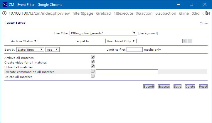

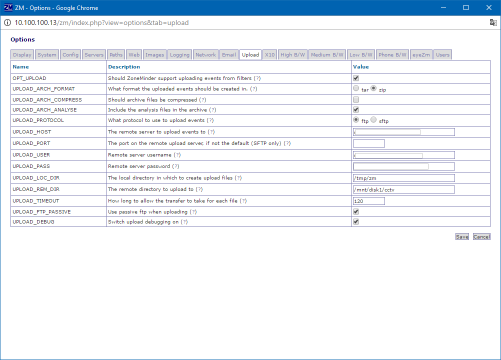

I'm using Zoneminder 1.29.0 and configured A filter to upload the events via FTP to a server. Everything is working fine, except that the zip file contains all the directory names. I want to get only the image filaes at the "root" of the zip. Is that possible?
I can see the zip command has the -j switch, which does what I want, but I couldn't find anywhere in Zoneminder's configuration to add that.
Below are the filter and the Configurations regarding the Upload options.
Maybe I can use a custom command on all matches to achieve this?
