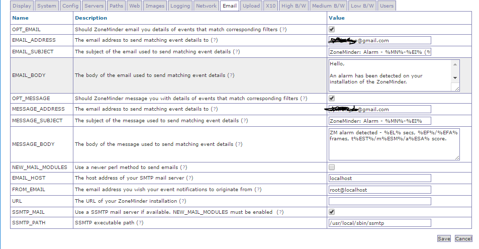

I currently have followed the WIKI guide and i can send e-mails from the command line using
"Hello, World" | mail -s "My email check" my@email.com
And that works perfectly fine.
However when i set up an alarm i get no love.
Wondering if i could get some pointers here is my configuration.
Thanks All

hrm thats unusal it is sending emails but its very slow.
seems to be about 3 minutes before the job is polling
edit,
that would be because of the FILTER_EXECUTE_INTERVAL (Options->System in the web console)
