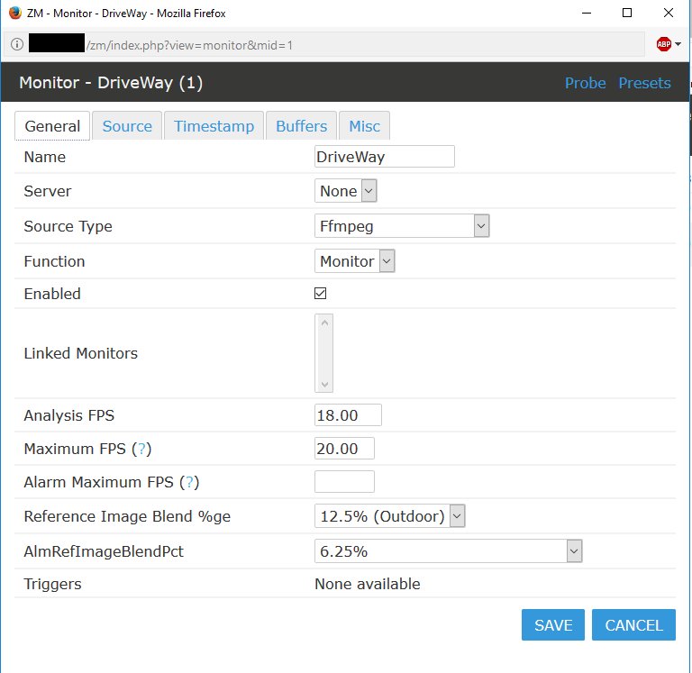

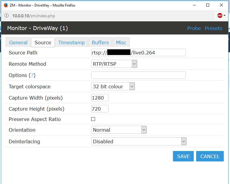

Update: I got the camera now working <for camera details see the Amazon link in my earlier post> and initially I did struggle but I finally got it working using Ffmpeg. After I also was able to get it working using the Preset option for H.264 as a Foscam FI8620 type initially this would have been the best way to start.
Question was (now solved), after a while the watch window went BLUE and has stayed all blue now no picture and I am not sure why? Load now is 1.05, but goes from 1.8 and 2.0 at times the disk is at 23%. I am not recording or doing any alarms. The reason was I discovered was that I had changed Maximum FPS from 18 to nothing but placing a value in there drops my Load back to 0.2 - 0.5 range. And I think its the cameras software that is acting up because when I try and log into it through the web I am getting a half loaded interface that is hanging up and timing out even my browser and I suspect that is my problem in ZoneMinder as well. The question remains though why was it running OK before for at least 45 minutes and maybe now that the outside temperature has dropped into the low 30's F. At this point I am thinking I am going to return this camera for another one and I might even try a capture card and a analog camera at this point.

  2. Then I read the camera documentation in it they show you connection strings using the cameras IP.
The pictures are what I used on the first successful connection but when I used Presets the Source Path was:
rtsp://<username>:<pwd>@<ip-address>:554/11
Source Tab.PNG (34.03 KiB) Viewed 6365 times
General Tab.PNG (37.97 KiB) Viewed 6365 times

Lower your resolution and try again. 640x360 If you get a blue screen again use VLC to view the image from the camera - Tools, Media Information.
remove values from Analysis FPS and Maximum FPS
set reference image blend and almrefimageblend to the same value 6.25%

I made the changes thank you for the tips; I also had to re-boot the camera, not sure why I did not think of this sooner. With those FPS text box's empty the Watch window now shows about 12.0 fps and the load is 0.48 - 0.62.
Update:
I started testing in Modect, and I must say I am very impressed with this system and how it organizes the motion detection events in a nice user friendly interface my hats off to the developers! My system load is now at 0.87 I am thinking this means my CPU is almost maxed out? Edit: user doc says A load of 1.0 means the processor has “just enough to do right now”.

Set the FPS in the camera down to 5 FPS. You seldom need more than that for most systems. Under The Config tab uncheck CREATE_ANALYSIS_IMAGES.
