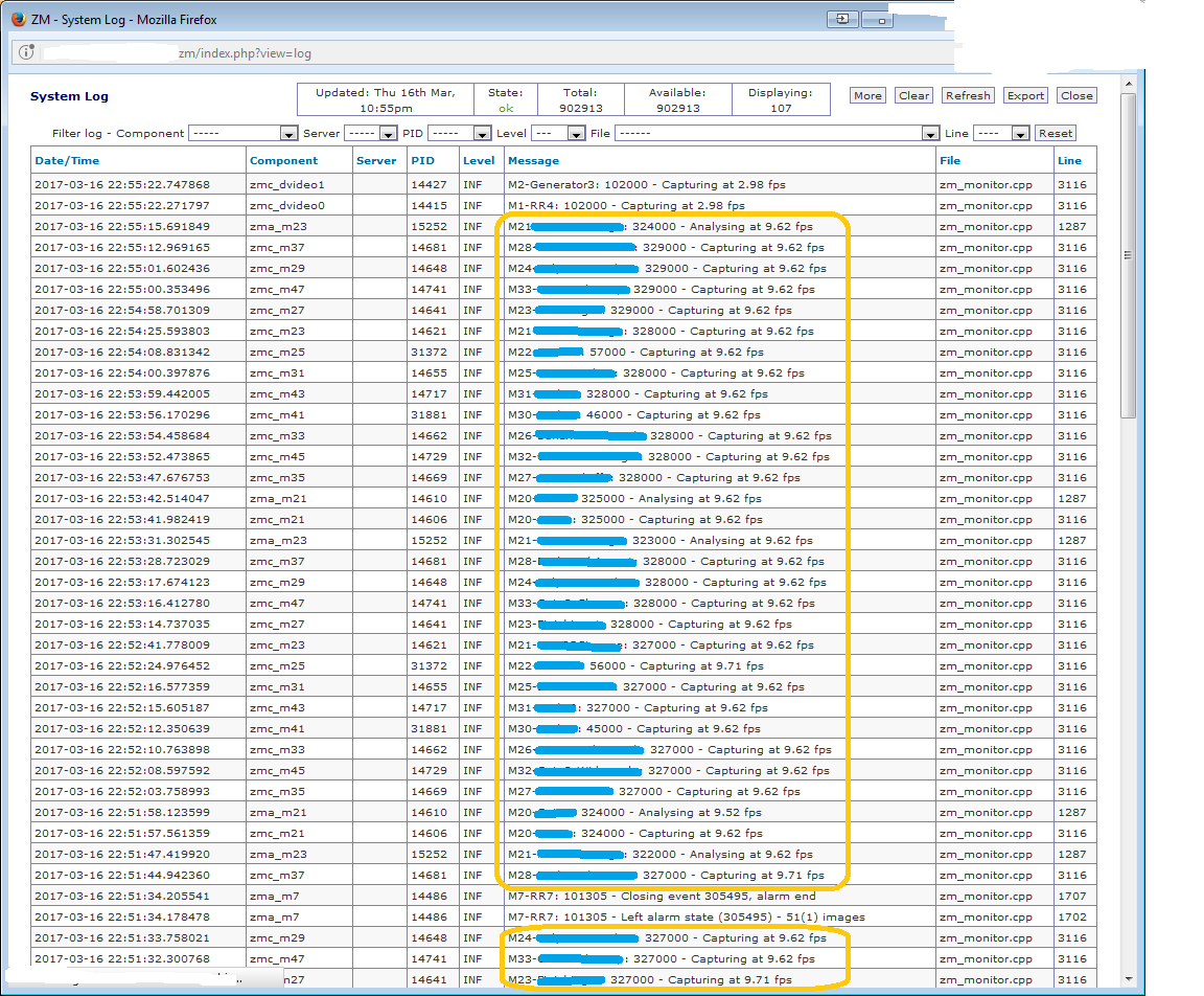

I am using 1.30.0 on Xenial. I have a few monitors defined for IP cameras through rtsp links with the function set to "Monitor". In the log, I frequently get entries that show the said monitors are either analyzing or even capturing. This is really confusing. What am I doing wrong?

I am attaching a screenshot of the log. I have marked the IP camera monitors by drawing a rounded rectangle around them. Btw, even though the log says the monitor is recording, no event is actually recorded.

2017-03-17 07:20:28.106871	zma_m2		5847	INF	DownStairs: 57000 - Analysing at 9.90 fps	zm_monitor.cpp	1296
2017-03-17 07:20:22.669362	zmc_m2		5796	INF	DownStairs: 57000 - Capturing at 10.00 fps	zm_monitor.cpp	3125

The IP camera monitors function have been either None, Monitor or Nodect. I have restarted zoneminder many times and the system has been restarted after every few days also. I still get these messages about Analyzing/Capturing. If I understand you correctly, in the log, "Capturing" is ok but "Analyzing" is not.
There are 16 IP cameras in all (in addition to old analog 16 cameras which I want replaced with the IP cameras). I want to use the motion detection feature on the camera itself and not in zoneminder (that is subject of another thread). In the pre IP camera setup, htop showed about 20-25% CPU utilization on this midrange i5 based system. With these 16 IP (additional) cameras in Monitor/Nodect mode, htop is showing 90% CPU utilization. This is when I started digging around the IP camera settings in zoneminder and came across the Anaylzing/Capturing lines in the log.

I put all monitors in "Monitor", stopped and restarted zoneminder. Now no zma processes are shown in the log. So all is good :D Thanks for all the help guys.
