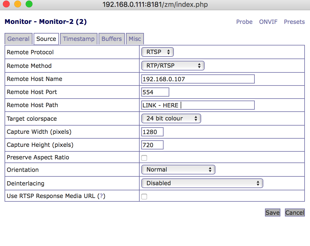

Been a long time since I tried this, but just got back to try today.
Notice that ZM now is reported as 1.30.4 so that might be the thing that made this WORK!
In the first picture, the "LINK HERE" is /user=admin&password=PASSWORD&channel=1&stream=1.sdp
Skjermbilde 2017-09-29 kl. 23.18.09.png (134.55 KiB) Viewed 4754 times

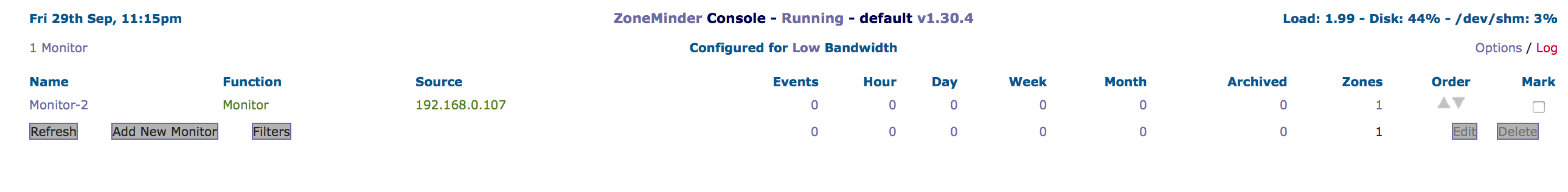

green link :)
green link :)
Skjermbilde 2017-09-29 kl. 23.18.25.png (83.08 KiB) Viewed 4754 times

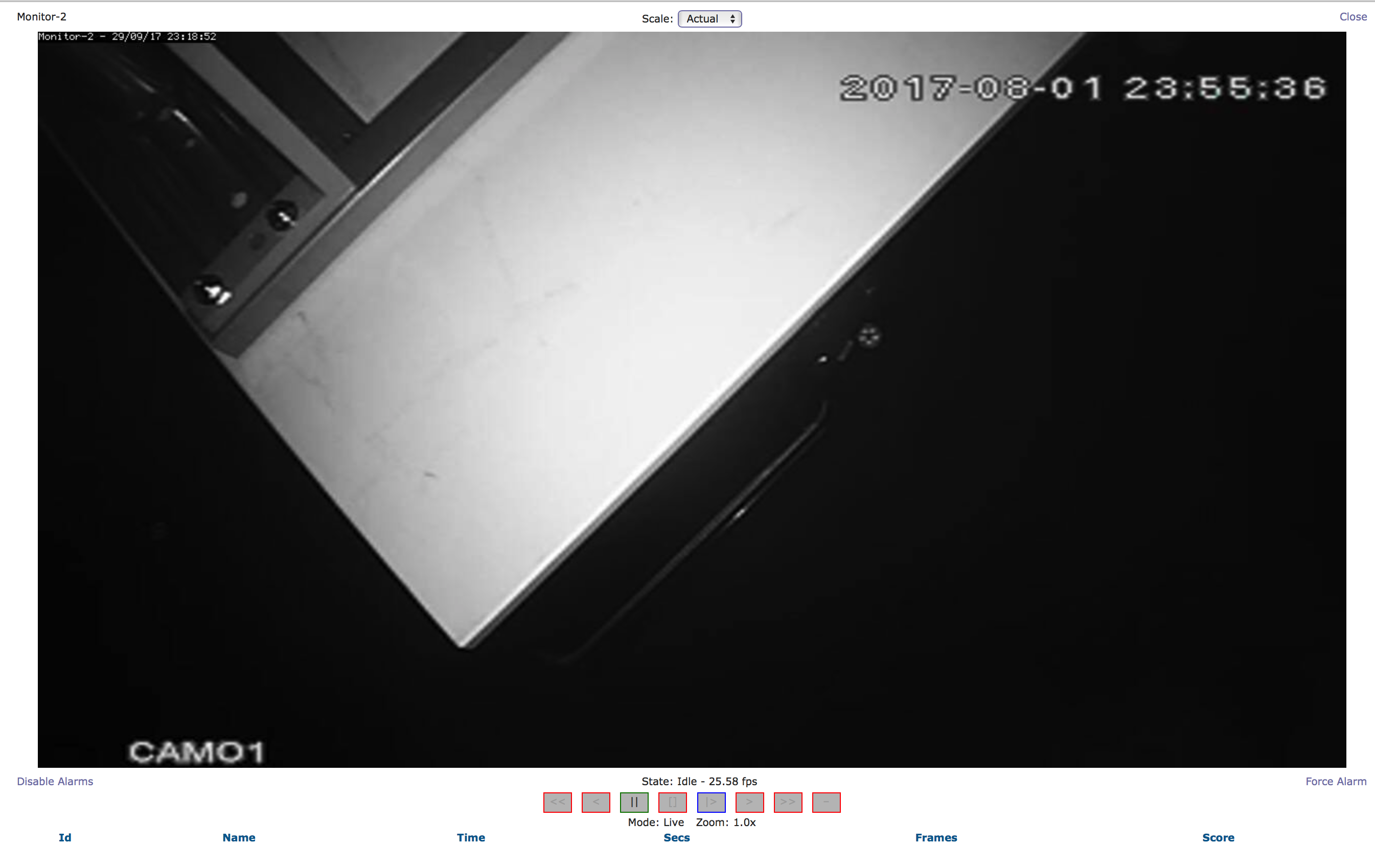

Picture from under my desk :)
"proof of picture"
"proof of picture"
Skjermbilde 2017-09-29 kl. 23.18.43.png (966.01 KiB) Viewed 4754 times
