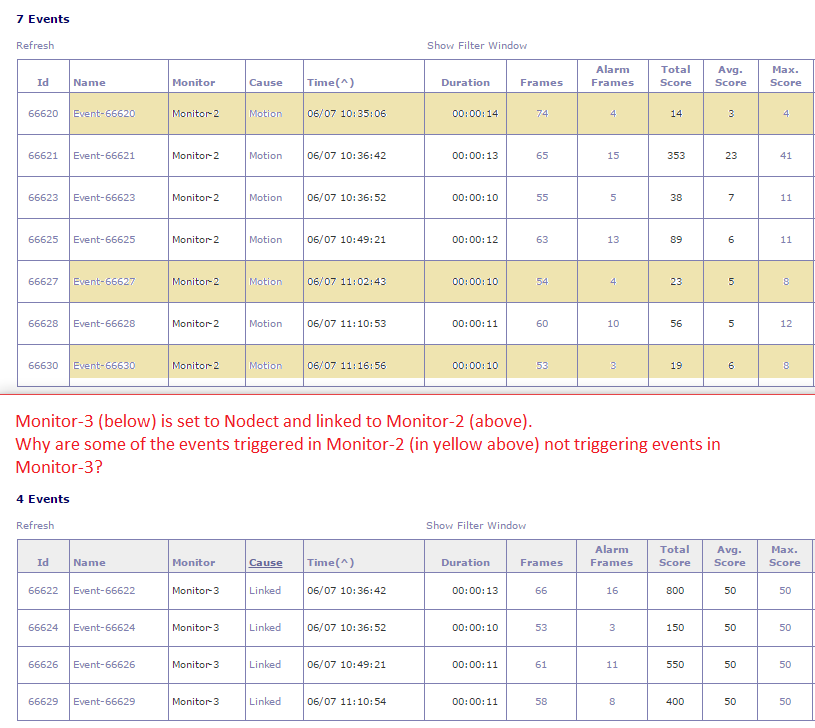

Does anybody else experience this too? I have monitor-3 linked to monitor-2, but some events on monitor-2 do not trigger events on monitor-3. See screenshot of events on a 1 hour period. I have 7 on monitor-3, but only 4 triggered monitor-4. Is this normal behavior?
I can see that the 3 events not triggering on Monitor-3 (highlighted in yellow) report alarm frames < 5 on monitor-2. Is that the reason? And if so is that a parameter we can change somewhere?
Also notice how the alarm frames and the score are different on monitor-3 compare to the same events on monitor-2. But where do these numbers come from? Are they not derived from the settings in the zones? But since monitor-3 is in Nodect and linked, I have no zones defined there...
I feel like I am missing some settings on Monitor-3 somewhere...
Linked monitors.png (49.91 KiB) Viewed 3123 times

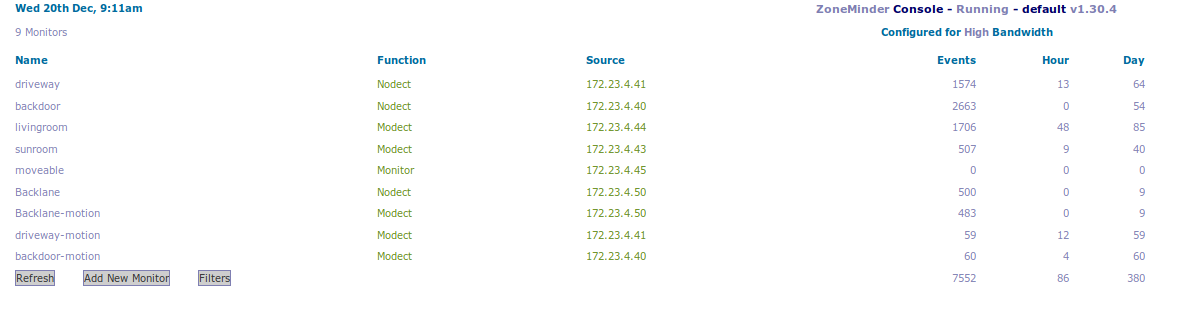

I'm going to post here instead of starting a new thread. I am having the same issue. I just had 4 events on my low res stream that did not propagate to my high res linked camera.
Attached is the image:
As you can see, there are 4 extra events on 'backdoor-motion' that there are on 'backdoor'
Does any one have linked monitors working 100%, or should I just not use them?
