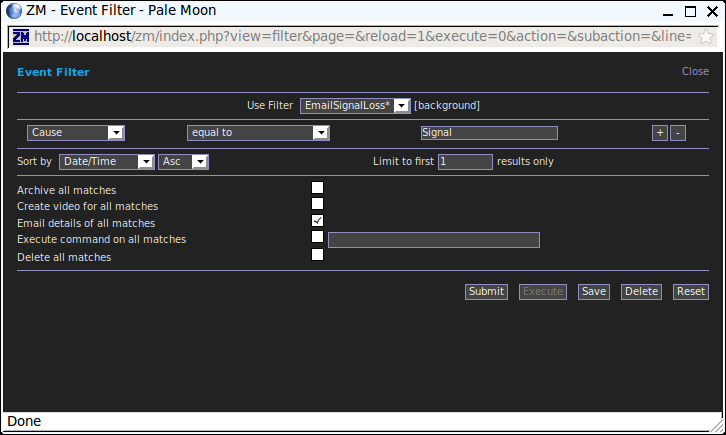

there is a parameter in Filters that is called "Cause". I use this as a rule condition that acts like
if Cause = "Signal" then do something
here is an example attached
I have a wifi netcam that loses connection once in awhile and will not recover sometimes and I noticed that the cause is "Signal"
so I use the cause rule also not to send and event email due to a signal loss but seems like one could actually use it to send a notice of camera failure.

I think that this filter will only work if the monitors are in NODECT, MODECT, MOCORD or RECORD. More information on how to construct the individual filters is here https://zoneminder.readthedocs.io/en/st ... vents.html
and there is more information and questions on the Filters floating around this forum in older posts, that you would need to search for but this section of the manual will get you started.
The Filters are a very important part of ZoneMinder and really come into play managing these type of events and are good tools for helping manage systems that generate a lot of events.
Good Luck!

This filter Cause= Signal only exist when a camera comes back online but not when when the connection is lost

interesting find. That is good to know. Then a script perhaps, a daemon that analyzes the logs looking for camera disconnect? There would need to be a function to directly address each camera and look for the correct response otherwise. I will experiment and look for a method to reliably detect a missing camera in a ZM setup.

I see that the original suggestion was to monitor the logs.......but what if one could use that function that does this and writes to the log and tap into that?
