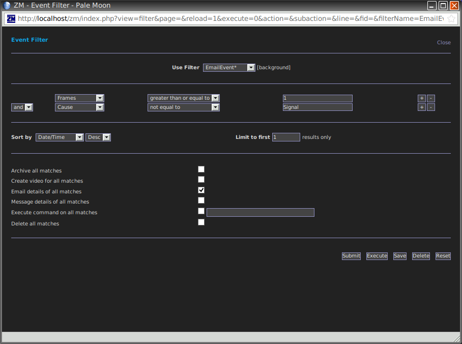

Every time I save a filter ZM resends every stored event over email. This can be 100's of emails. How do you avoid this?
For example...say I want to change a parameter like time. I then Save the filter, and it goes back months of events and resends any matches, flooding my mail service.

this is what works for me....sends just one email for the current event.....how are you saving the filter that is starting to run?

I have it set to send 1 event also.
Usually I just hit the Save button, but I have tried them all.
Submit, then Save...or just Save
I end up having to delete all stored events, as it will resend emails from months earlier.

have you tried deleting the original filter and creating a new instance of the filter? Save then with a name, Submit will run the filter without the action assigned to it.....Execute will manually run the filter.

I did not delete the filter, but edited it by removing time windows, saved and restarted service.
That seemed to fix it.
So...the proper method when adjusting an existing filter, is to first Save, then Submit?

the method you used works also. Select the filter to edit, make the changes, make sure the correct filter Name is in place, then save. A ZM is a good habit but I think the filter edit and save may not require a restart to function. Although the ZM restart is good practice.
Submit button will run the filter and show the events that filter selected without actually executing the action (i.e. send email, delete event..)
Execute button will run the filter, select the events according to the filter and run the action selected. This is a manual way to run a filter that is not in a "run in the background" mode.
For more detail see the ZM manual HERE
