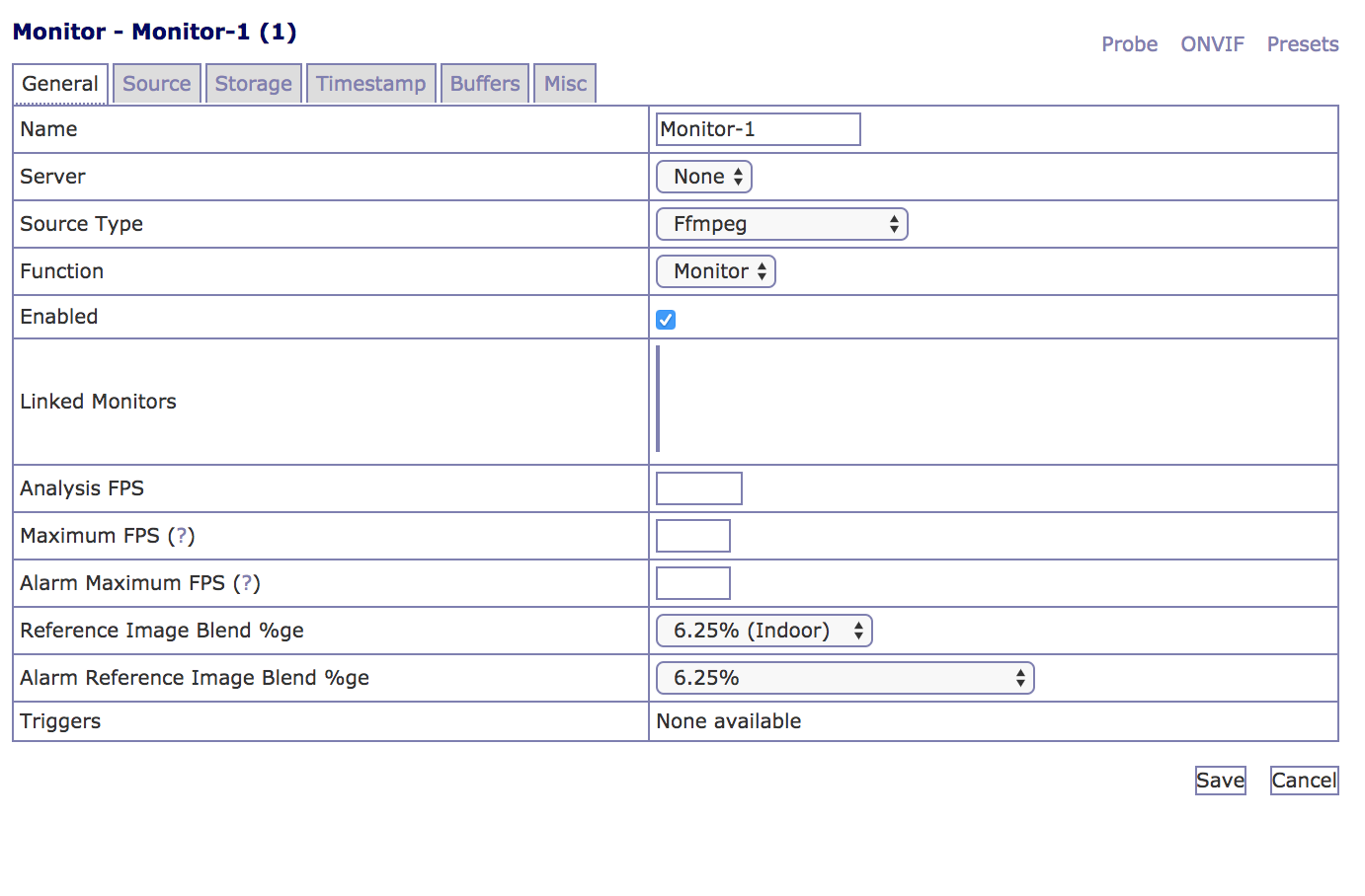

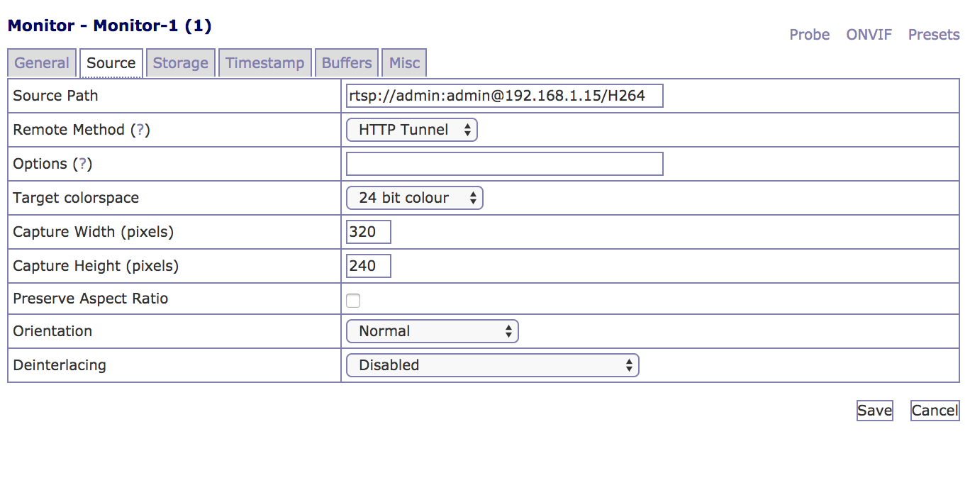

I visited the website and found the path for my model but I'm not sure whether I setting the parameters correctly.
Screen Shot 2018-04-14 at 15.20.48.png (141.58 KiB) Viewed 52303 times
Screen Shot 2018-04-14 at 15.20.13.png (108.4 KiB) Viewed 52303 times
Screen Shot 2018-04-14 at 15.19.48.png (120.72 KiB) Viewed 52303 times
As you can see I generated the url, the IP address I'm using is the one that allows me to connect to ZM remotely, what I mean by that is that if I put the ip address in the browser with the port number, it will take me to the ZM interface. I assume that's the IP address I have to provide to the generator right?
After setting those values, I am not being able to get anything from the stream. I am not even sure if my CCTV is running.
I have connected my POE camera through a cat6 ethernet cable that connects the pc to the camera. Will the camera be getting power through the PC?

Re: Setting up Zoneminder for the first time
have you tried to change Remote Method to TCP or something other than HTTP TUNNEL?
