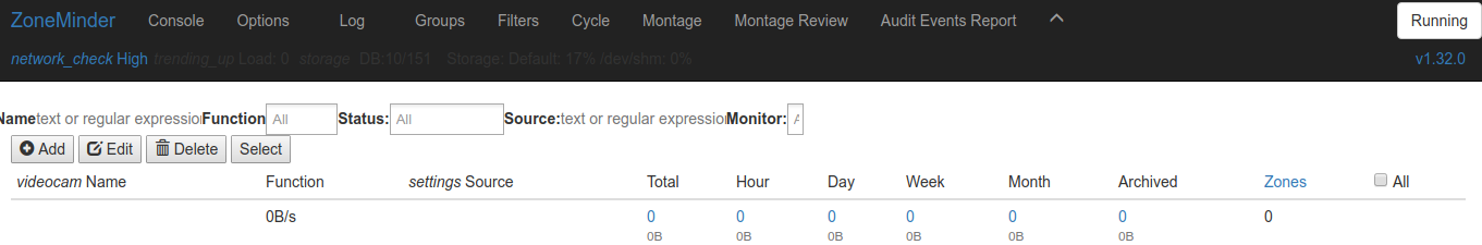

Screenshot at 2018-09-27 08-48-56.png (41.48 KiB) Viewed 10624 times
I realized the Web interface might have some indications as to what part of the config is messed up.
Seems like elements like Name and Source are displaying fallback info rather than the intended content.
Does this help anybody to give me a clue?
Re: Futz'n with LEMP
Posted: Thu Sep 27, 2018 9:04 pm
by moorsey
For me, this was a missing "cache" folder in "/var/cache/zoneminder"
Not sure if same issue, I'm using Docker and not sure if unique to that. But may be along the same lines
https://github.com/QuantumObject/docker ... -423478617
