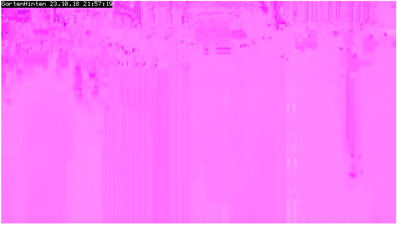

Hey,
I am very happy with the new Zoneminder version and everything works great too. The only problem I have is that two cameras that stream over RTSP sometimes turn purple, as seen in the picture below. The only thing that helps is to restart Zoneminder.
Bildschirmfoto 2018-10-23 um 21.57.20.png (432.43 KiB) Viewed 5610 times
I'm using this https://www.aliexpress.com/item/Built-i ... 4c4dIx2ces cameras.
Another "problem" I have is this warning, which completely spammers my entire log. I do not know if it's related to that, but it also happens when you mouse over a thumbnail and the video from an event plays there.
No sd in checkCommandQueue, comms not open?
Thanks :)

Try switching to TCP under Source in Monitor Settings.

Its not working. Seems the camera needs UDP :/
When I change to TCP the Stream won't show.

I would go start checking for layer one issues aka bad/overloaded cables or switches. Your likely getting packet loss some ware along the line. Remember udp has NO error checking so this can happen with a bad link.
Also make sure you don't have some device in your connection acting as a hub check for duplex mismatches.

Does the camera stream with VLC?

Yes the the camera does stream with VLC.
