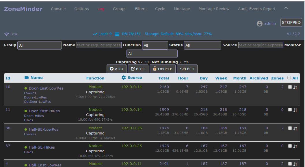

I had a working zoneminder v1.32.0 system until I upgrade my host server from Ubuntu 16.04 to 18.04 using do-release-upgrade. The upgrade of the server seemed to go fine but now zoneminder won't display anything other than the main, console, page. I can't access Options, Log, or any of my camera setting pages; the pages just display menu options but no data. Also, the menus displayed don't respond to mouse clicks. Apache logs something similar to a 404 saying "Can't find variable: submitTab".
I have one of my cameras configured for Mocord and it's still recording events although I can't view them.
Again, this system worked fine prior to the OS upgrade so I don't think the issue is with the ZM settings. I've check config files under /etc for Apache, ZM and MySQL and none of the files were modified during the upgrade. BTW, all of my other webpages which are hosted on this server are working fine just as before the OS upgrade.
Ideas? Has anyone else had this issue?

is this the current status? can you share a screenshot of what the web console looks like?

The only problem remaining is that the button in the top right corner of the screen says "STOPPED" even when ZoneMinder is running.

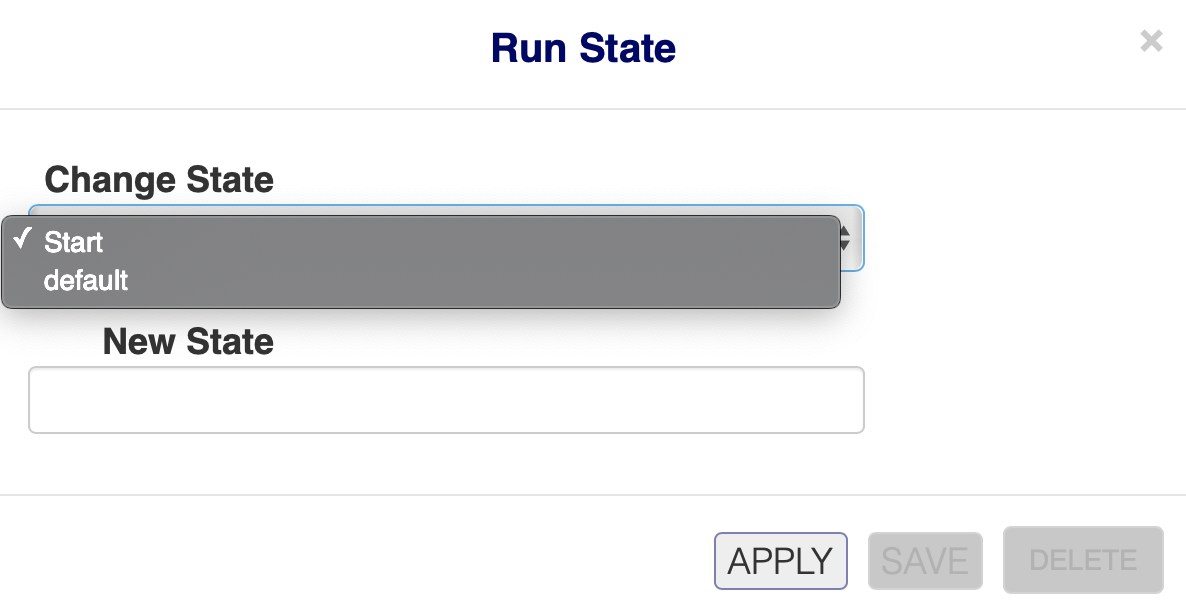

does the Stopped button open a popup window with the run states, start, restart and stop?

The Stopped button popup only shows 'Start' and 'default'.
- Stopped Button Pop-Up
- popup.png (111.93 KiB) Viewed 10140 times

Same issue with v1.32.3 on Ubuntu 18.04 server after upgrade.
Zoneminder appears to be working but indicator shows "stopped" with ony "start" and "default" as entries when clicked on.
