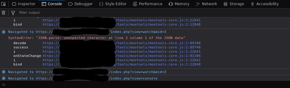

I have a bit more information on this. I noticed in the browser debugging tools that every time I see this stop/restart in the stream, I get an error like the one in the attached image. I get this when I stream from a camera that is on a different server than the one I am connected to.
How can I go about debugging this? Is this a mootools problem? Sorry, not at all familiar with mootools.

As a follow-up to my own post, it appears that turning on ZM_AUTH_HASH_LOGINS solved this. While testing with zmNinja it popped up a message stating that this needed to be enabled. Once I did, this problem went away. ZM_AUTH_HASH_LOGINS is apparently off by default in 1.32.2 and it wasn't obvious to me that it needed to be on until I got the message from zmNinja.
