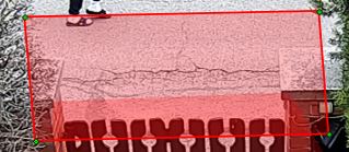

I have the following setting for this zone (see below). Now it is recording all of the pedestrian and passing cars, motors, etc which can be seen on this zone window. But i want to record ONLY when someone stopps at the door, not every motion. Is that possible? If yes, what settings should i choose. Unfortunatelly the settings are not clear for me.

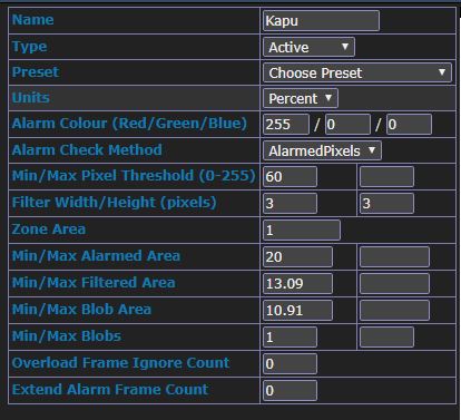

So the settings now:
Here the zone, which is not so big:
And the frame sizes:
Zones settings pls help

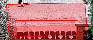

Based on the picture, the person walking is that a
1.Sidewalk ?
2.Parking lane ?
3.Driving lane ?
Make the trigger zone narrower till you don't get false alarms
1.Sidewalk ?
2.Parking lane ?
3.Driving lane ?
- zone-narrow.jpg (57.32 KiB) Viewed 3130 times

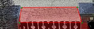

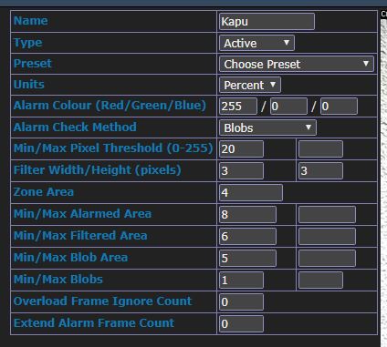

Thanks, tried to reduce the triggering zone, but no change. Also lovered the settings to Fast, Low Sensitivity, no change.
This is a small street, with walkers, cars, etc.

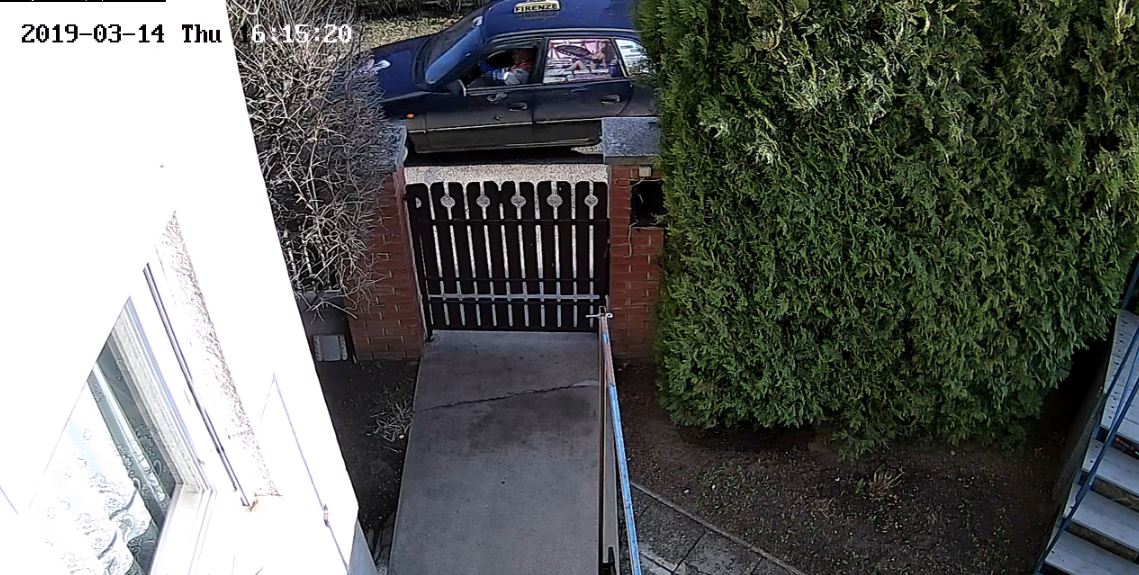

Here a car is passing by )was not slow...) The new trigger zone: And the new settings: I have another zone, a bigger one, for the area in my garden, but also tried to extend the triggering zone to a little bit higher than the door, but was not ok. Without the second zone (which should only record when someone stops before the door) the recording only starts when someone is in my garden.
