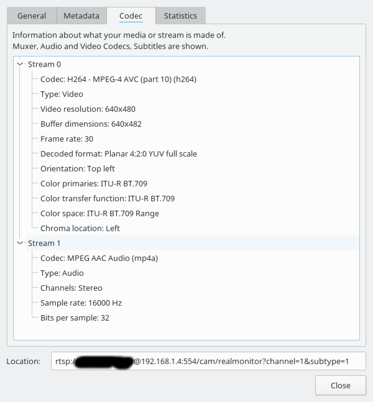

I found about 100 matches when searching the forums, but haven't yet discovered a solution after reading several of them. vlc displays the Amcrest IP4M-1053EW rtsp low-resolution image correctly with
rtsp://user:passwd@192.168.1.4:554/cam/realmonitor?channel=1&subtype=1 :
The camera is configured this way:
The Subject: error gets generated very frequently:

There may be some settings on the camera that can be adjusted. What are the stream settings?
What is the software / firmware version of your camera?
What have you tried already? Be more specific.
