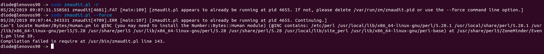

This is my second install of ZM after the first computer I had it on decided to crash. I'm running Ubuntu Server 19.04 and I'm having an issue with zmaudit and zmfilter where it thinks that it is running, but the PID that it references doesn't exist. The error that I'm receiving is:
Error Log.png (141.48 KiB) Viewed 4429 times
I have tried forcing the zmaudit as suggested in the log, but I receive the following errors:

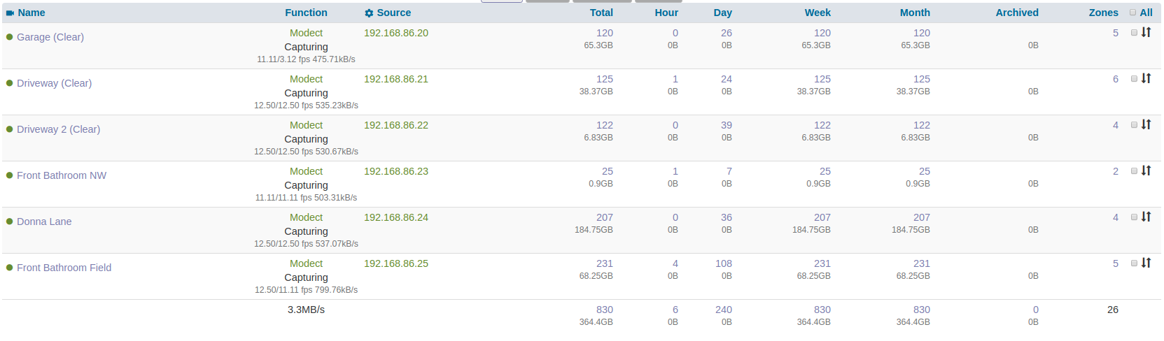

I'm also noticing that the main page is not reporting correct storage for the files which I'm guessing is because zmaudit is unable to run:

I've tried refreshing mysql, restarting the machine, and several other troubleshooting techniques to see if I could get the zmaudit to start working, but I'm starting to think that either I'm missing something for the installation, or there is something deeper that I just can't figure out. The error in the comand line indicates that I may need to install the Number::Bytes::Human module, but I have no clue what that is and I didn't pull anything up when Googling.

You need to install the libnumber-bytes-human-perl package. sudo apt-get install libnumber-bytes-human-perl
How did you install ZM? That library is a dependency and should have been installed automatically if you installed using our packages.
