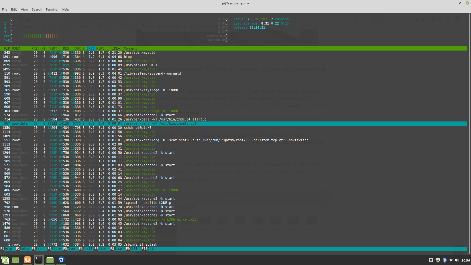

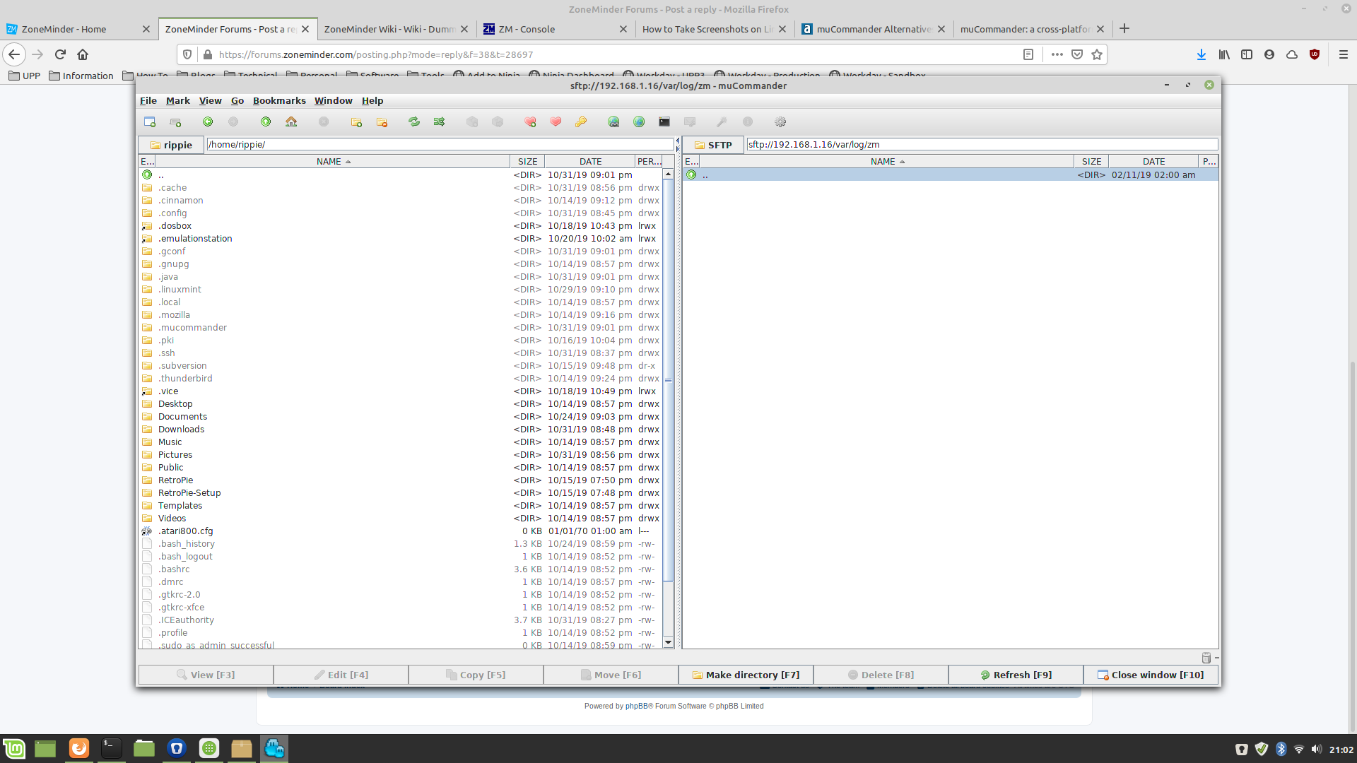

Hi Snake, to be honest at the time of writing i did not have a problem other than the error in the log. But i did ask because i am unable to get a RTSP camera to work here but i know it works because in Shinobi it worked/works.
there are no files in /var/log/zm (please see screenshot)
Also included a screenshot of htop
I am new to this linux and zoneminder, so please bear with my Linux skills :)

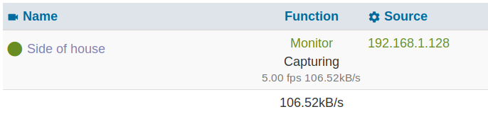

And a good day was had by all :)
