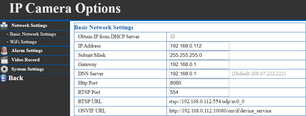

As a test I gave the camera a fixed IP address and a fixed port (port 8080). If I point the prowser to http://192.168.0.112:8080 I get a response:
picture 1.PNG (21.61 KiB) Viewed 3579 times
If I go to the network setup screen (not on above picture) I get this:
picture 2.PNG (48.53 KiB) Viewed 3579 times
I have tried the RTSP URL, with and without a username and password in the URL. It does not work if i does not add usernavn / password, so my RTSP URL are: http://admin:PassWord@192.168.0.112:554/udp/av0_0. This URL are working in VideoLAN, so it must be correct
