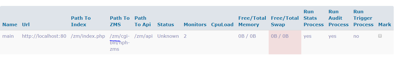

I am trying to finish configuring Zoneminder 1.32.3 on 18.04 Xubuntu, which seems to be a butchered upgrade from zoneminder 1.28 & 14.04 Xubuntu. I included more detailed notes about the INSTALLATION HISTORY further below. After I setup my 2 monitors, I needed to add a server because there wasn’t one in the Options - Servers.
Is this normal on setup to add the server or should there have been a default server when first installing Zoneminder 1.32.3?
server setup.PNG (13.46 KiB) Viewed 3944 times
It seemed like I had an issue at the end of the easy installation when the instructions said to change Options - Path: PATH_ZMS is set to /zm/cgi-bin/nph-zms
I couldn’t find that until I added a server and found it. Once I added the ‘/zm’ to the string then I had LIVE streaming in Montage Review.

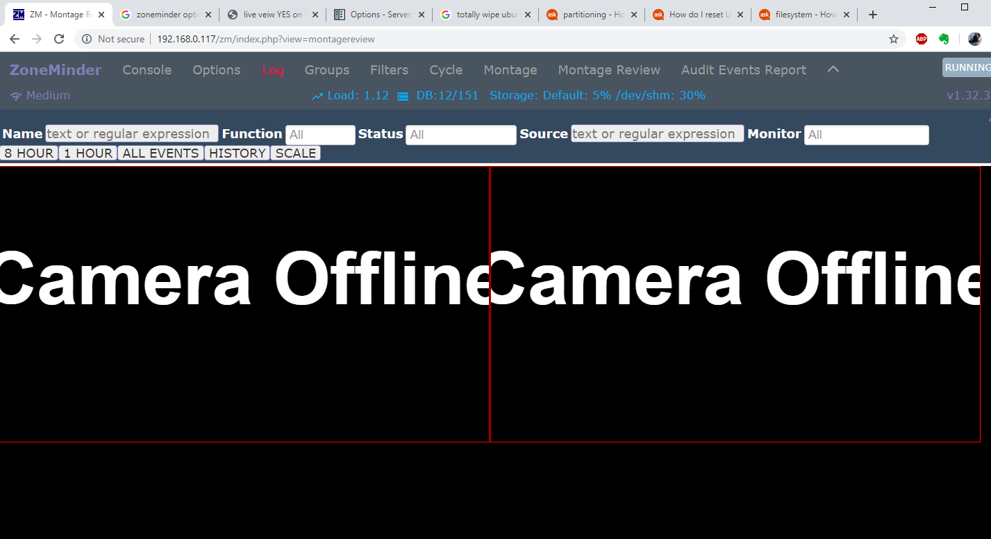

The 2nd issue is I cannot see live streaming video from a different computer on my home LAN pointing to the local machine with a browser pointed to http://192.168.0.117/zm/index.php. I can see live streaming video from the local machine when using localhost/zm. I can also change options from the remote computer.
camera offline remote pc.PNG (61.09 KiB) Viewed 3944 times
Events appears to be working - I have both cameras setup as Modect. I can select history in Montage Review and move my cursor to an event and view it. This works from a remote computer.

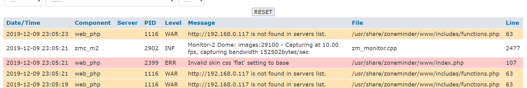

A WARNING? I also have this:
WAR http://192.168.0.117 is not found in the servers list /usr/share/zoneminder/www/Includes/functions.php 63. This warning came when I viewed the LOG from the remote computer. If I close the log window in the remote computer, then it goes away.

You only need to setup multi-server if you have multiple servers.
When you entered a server for localhost, you told it to generate all video urls using localhost as the address, You need to change that to be the ip that you will always access the server at.

Also, when I logged into the local machine late last night to shut it down, I did get the ERR Invalid skin css ‘flat’ setting to base.
log shot.PNG (58.67 KiB) Viewed 3928 times
Anyway - I think this has to do w/ my server in the tab and will try to figure it out tonight.
