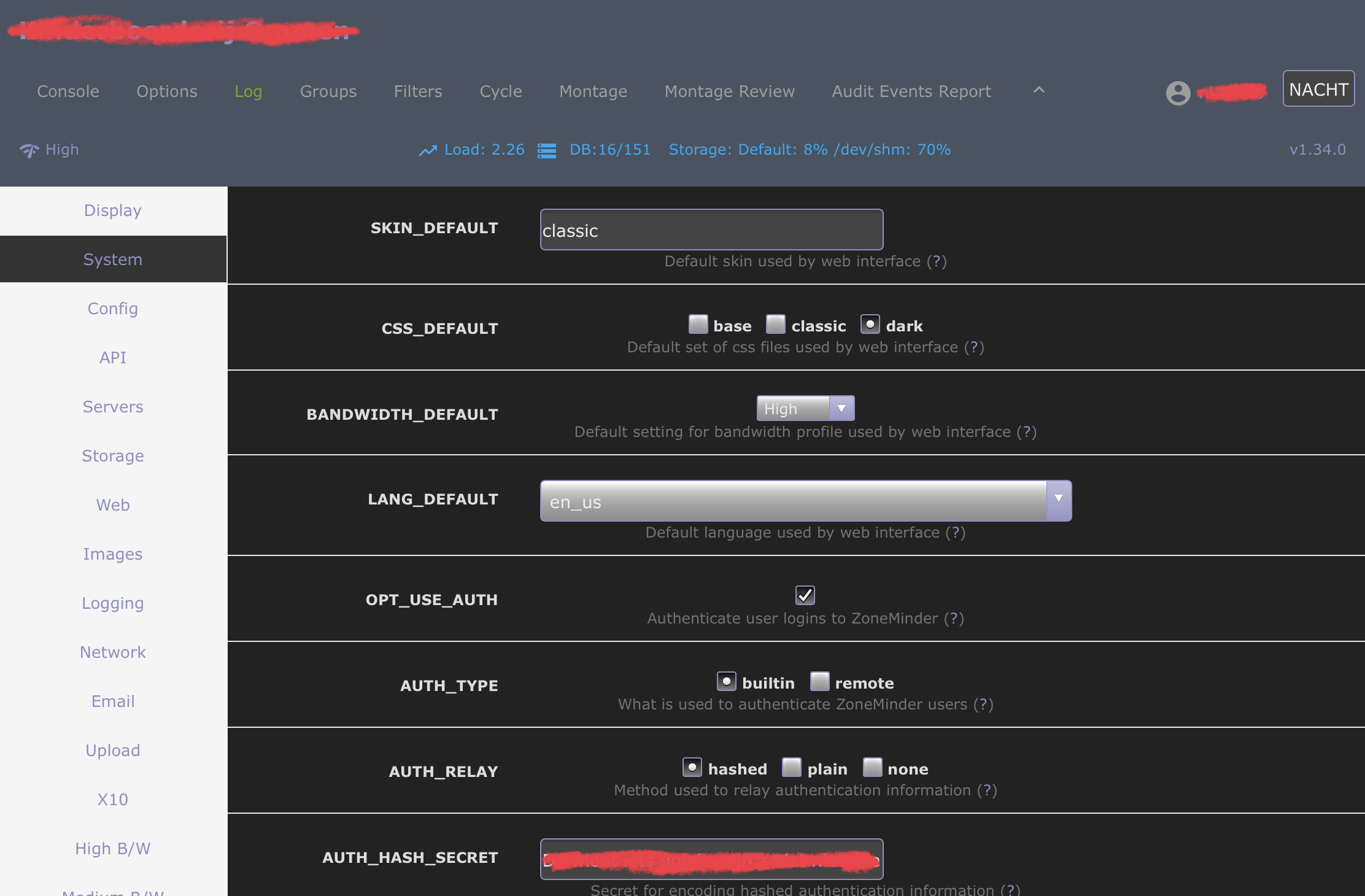

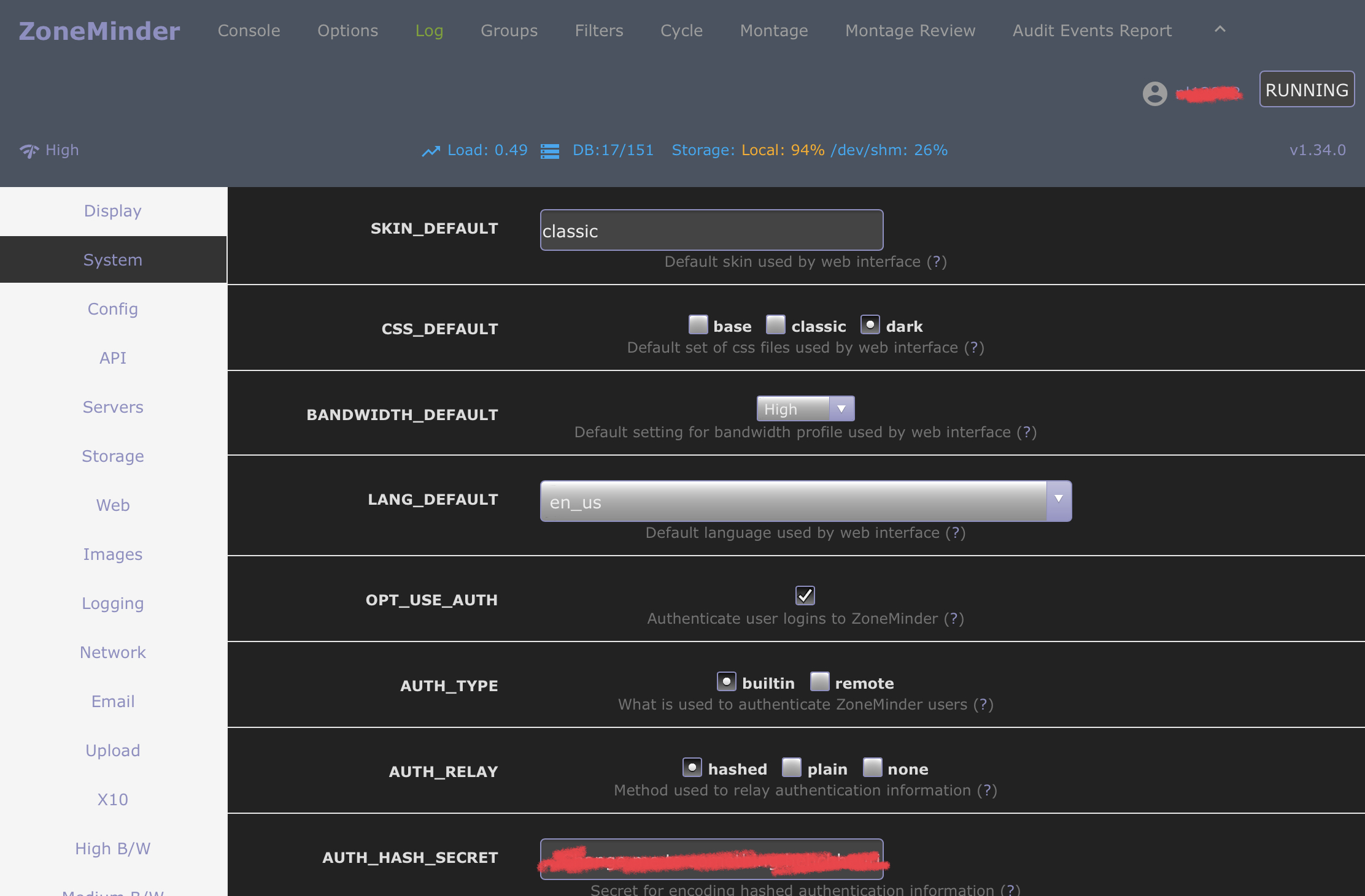

These are the settings of the system that does not work:
These are the settings of the system that does work:
I see no difference in options so it must be something else.
