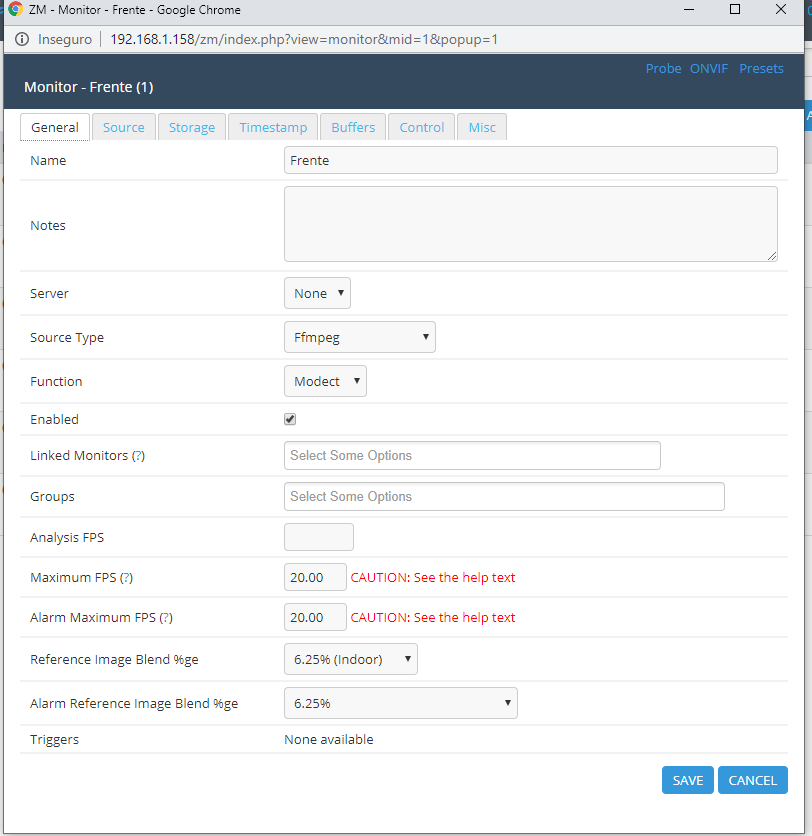

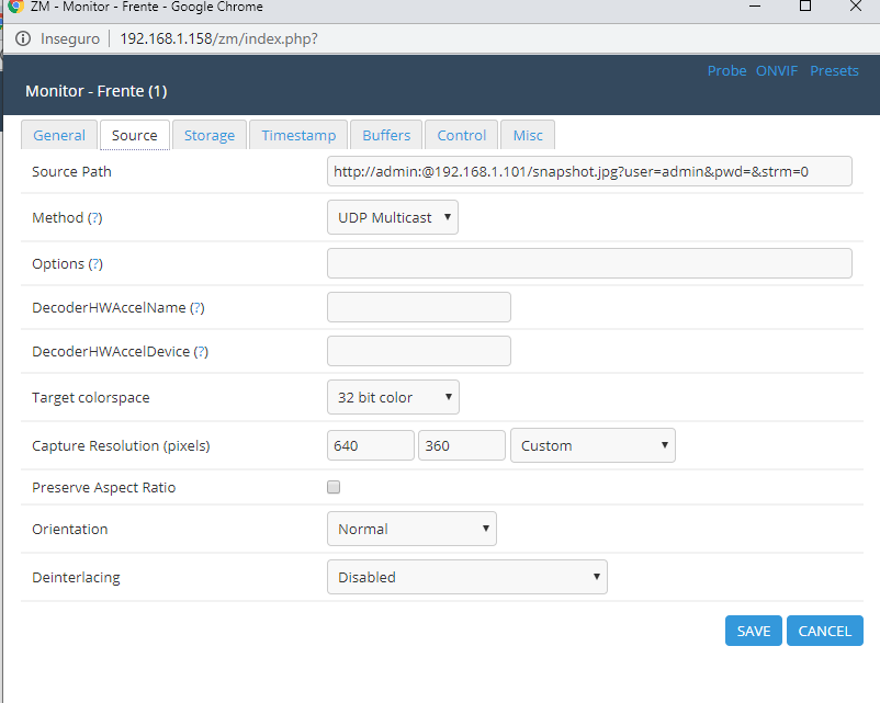

I have a camera here that I can get to work on the zoneminder. It is working by ffmpeg, but it only updates the image every 5 seconds.
They know how to tell me how to put the camera faster.

Camera make and model? Settings used in Zoneminder?

I'm using linux mint 19.3 and the camera is szsinocam ipc-5007w20eu.
on vlc and ispy it works fine, but on zoneminder it's slow

Method should be TCP
Maximum FPS blank
Alarm Maximum FPS blank
