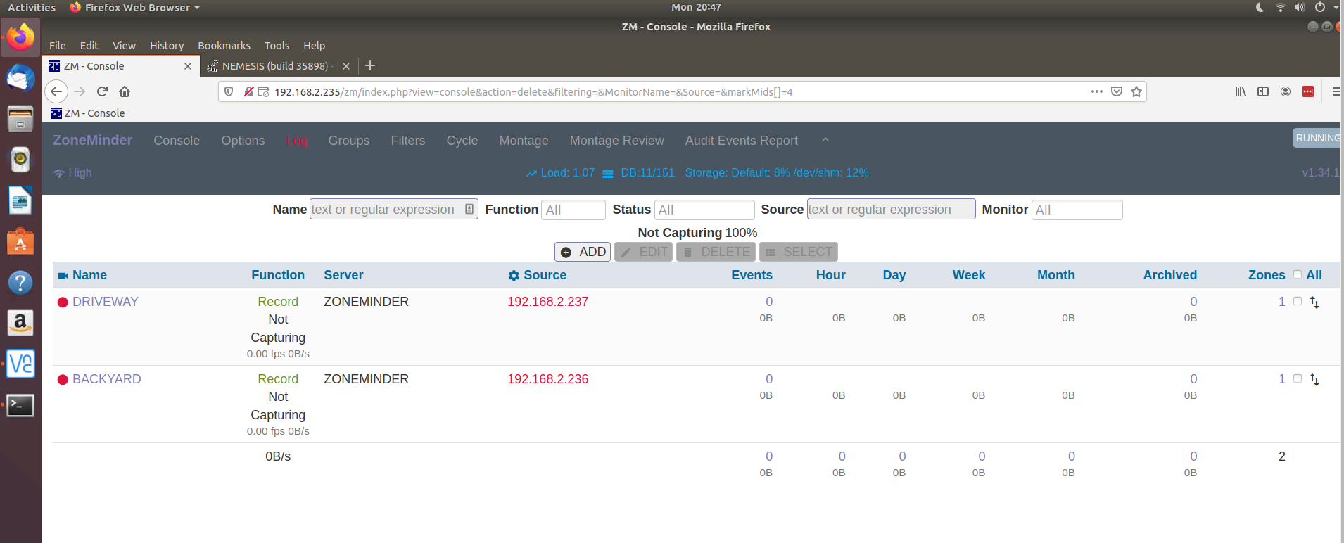

I have a PI-4 with 4GB and a 250GB SSD running ZoneMinder. I have never used any software like this in the past, so I am a novice at setting it up. I used a PPA (ppa:iconnor/zoneminder-1.32) and managed to get it installed. I further upgraded to 1.34.1, successfully. I have managed to get it displaying within Firefox and it seems to present properly. I can see my cameras but I cannot get them to show video. I was able to use ONVIF, through a WIN7 machine, and view camera output (so the camera(s) are working. I attach a screenshot of the current state of things. I am not sure exactly what to do next.
My system is a PI 4 running a Ubuntu distro and ZM 1.34.1 . I have attached a text file which shows the Distro that I am using in detail.
Any help would be greatly appreciated...
Robert
Robert
- 2020-02-03-PI-4-ZM.png (194.92 KiB) Viewed 175959 times

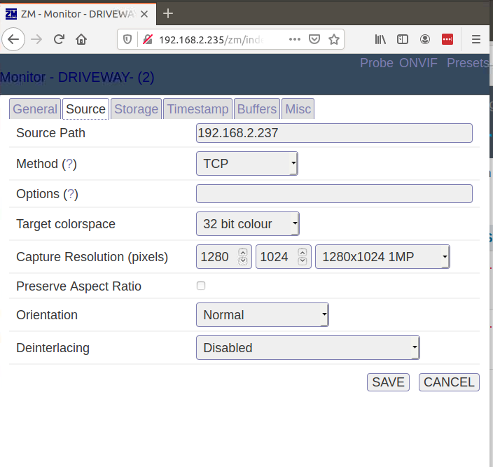

Post the settings from the source tab of your monitors. I suspect that the url to the camera is wrong.

Hi iconnor
Hope this is what you are looking for. By the way are the IP Cameras, I am using, work with ZoneMinder?

Usually you need more in the source path than an IP address. This can be different for each make and model of camera. Here are a couple of examples of Source Path I use for my old cameras:
http://192.168.1.231/mjpg/video.mjpg
http://192.168.1.233/img/video.mjpeg
rtsp://192.168.1.241/live.sdp
Your camera manufacturer should have information on accessing the stream. Otherwise Google is your friend...
As for my comment on resolution, the wrong resolution setting in Zoneminder is a problem with a vast number of "can't see video" problems. We recommend testing the camera in VLC as it will adjust itself to what the camera puts out and, per my instructions, will show the resolution the camera actually uses which can be different from the published specs.

I was able to get by this problem and finally found the problem. The Source Path turned out to be:
I never would have guessed that one.rtsp://192.168.2.237//stream1
I used VLC and some information from the Camera Vendor to get the Video to Stream properly. I am now able to get back to ZoneMinder and hope to use it soon. I just post here to let you know that my JOOAN JP-734ERI-P Cameras are working fine. I am looking forward to getting up to speed on ZoneMinder and I have installed Version 1.34. It has installed and seems to be running fine on my Raspberry PI system. Thanks for the help...
