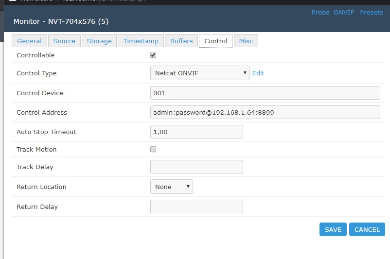

Re: Helo configuring XM530 BESDER
hi,
i use with XM530 hisilicon (similar CAM)
test it
test it
- ptz.jpg (65.57 KiB) Viewed 6430 times
Hello!
I've no idea why but leaving as Control Device the default or putting '000' the value was not used/taken, so I've copied the Netcat.pm to a custom one and added the control_device to '000', otherwise it was starting with something similar to 'onvif/device_list'.
BTW in that way it works, so it's similar to your settings.
Thanks a lot for the support!
Simon
