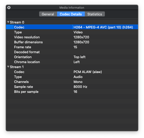

So, i have a 9 camera and 7 work well... 2 not capturing. (it's a different model). My ZoneMinder is on MacMini Server (old generation, middle 2012) On last Debian Buster 5.4.0-4-amd64 #1 SMP Debian 5.4.19-1 (2020-02-13) x86_64
The camera model is S5-T, buy from Ali, is a very cheap camera ^^ Only Wifi. in H264
i Have this message in the journal
Unable to open input rtsp://admin:xxxxx@10.15.67.148:554/realmonitor?channel=0&stream=0.sdp due to: Invalid data found when processing input
Failed to prime capture of initial monitor
If i try on VLC, it work well, no error ...
VLC
VLC
Screenshot 2020-05-05 at 06.12.09.png (78.5 KiB) Viewed 10053 times
I try to change UDP/TCP, Resolution, etc... What can i do ?
