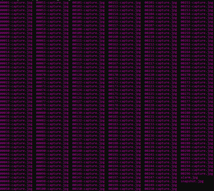

2020-08-07 09:04:28 zms_e70 13350 ERR Can't open /pagemaster/zm_storage/events/1/2020-08-07/70/02373-capture.jpg: No such file or directory
But here is the directory itself, with a max file # of 292:
directory contents.png (27.67 KiB) Viewed 45369 times
From your comment, iconnor, it would appear that Allan and I may have different causes leading to similar behavior.

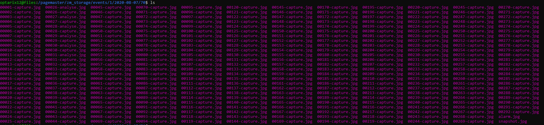

Interestingly, it looks like it starts to play the files there, but wildly overruns the # of files that are actually present.
Here is an example where I just forced an alarm manually, and looked at the errors that were generated when I went to play it back in the browser.
Here is the complete directory contents list:
directory contents 2.png (27.57 KiB) Viewed 45365 times
And here is where the errors begin in the log:
Errors event 79.png (138.68 KiB) Viewed 45365 times
There are thousands of errors in the log after that point, all of which generate in just a few seconds. Is there some setting that went wonky, making it mismatched between the rate or duration it thinks its recording at versus what it actually is?
