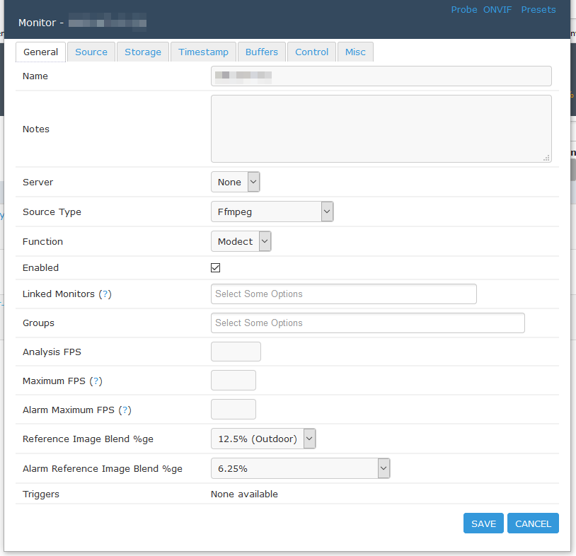

From the ZM server I can't use the ffmpeg codec. it keeps stating that the used query/ code is invalid or missing arguments.
The current settings are:
changing it to libvlc doesn't resolve it.
FYI I have another Hikvision camera connected (DS-2CD2143G0-I). This a regular POE cam and works without any issues.
The cam is in the same vlan as the doorbells and connects to the ZM server that resides in a different vlan.
