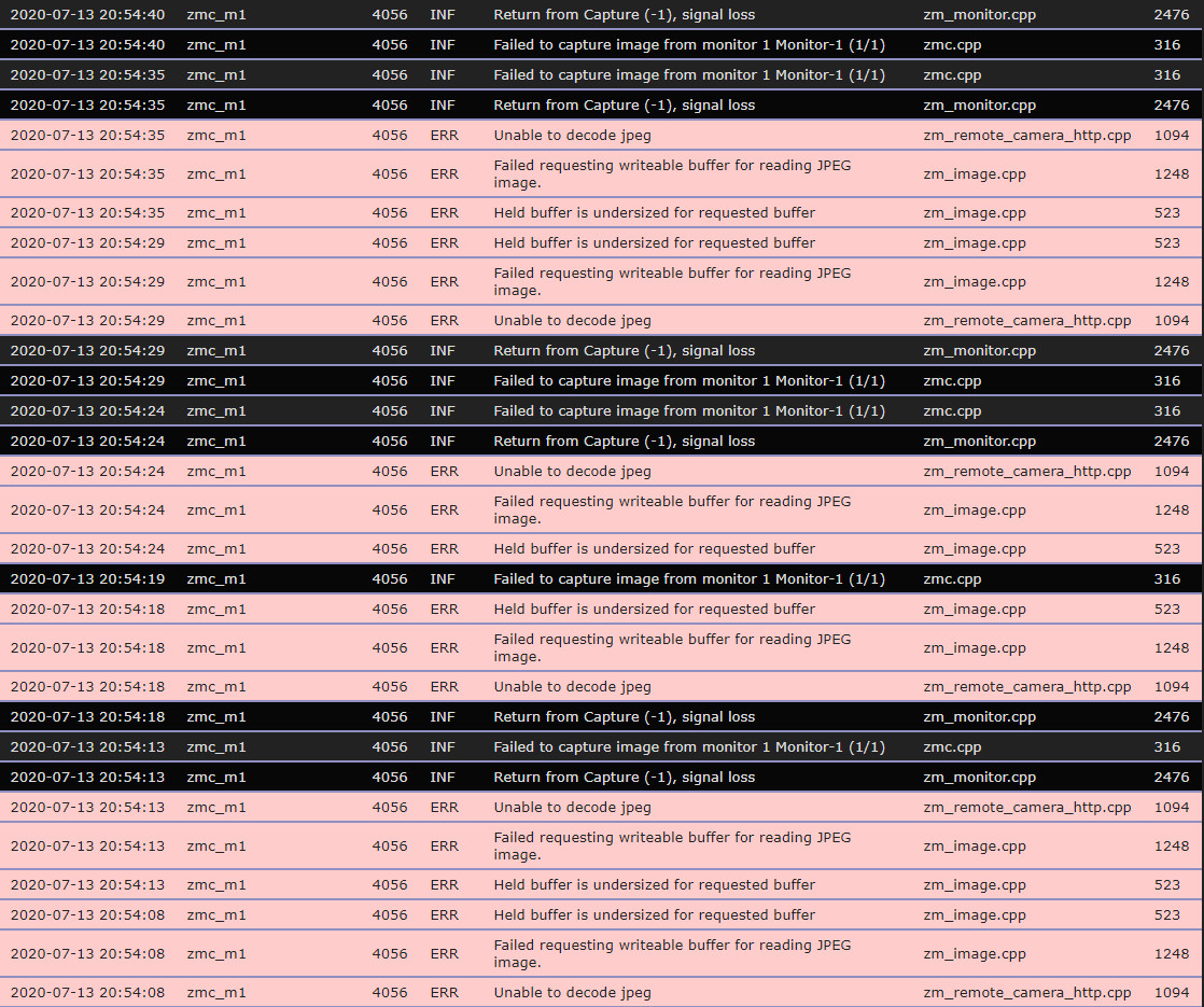

This one runs but no monitor to view (Not Green)
I know the camera works via vlc and web app and it was running ok master=1.35.5 on Linux mint 19.3
When I upgraded to 20.04 hence this problem using the same monitor configuration
I'm missing something
Attached jpg of errors, just keeps repeating
Thank You
Jimmy

Looks like you have a buffer permissions problem.

Log (attached) seems the same as I posted if I have the correct one
Jimmy
Jimmy

GOT IT!!
Camera > Source > Path = "/nphMotionJpeg?Resolution=640x480&Quality=Standard
was imputing "nphMotionJpeg?Resolution=640x480&Quality=Standard"
I never backed up my monitors table since I only have one camera but I did have an older one that did not have "/" in the table. So I just exported the monitors table in 1.35 and it does have "/"
Jimmy
