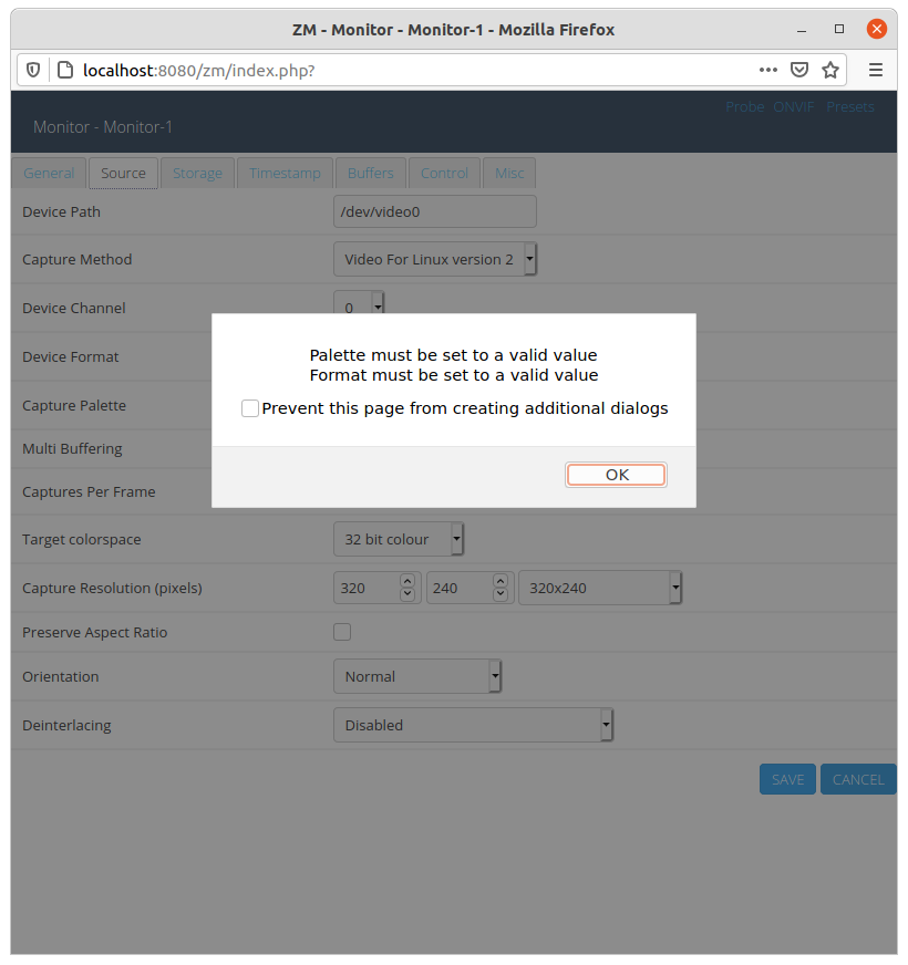

When I try to add USB camera monitor to ZM-Consol , I have got a popup message stating "Palette must be set to a valid value & Format must be set to a valid value" .
I have set Device format = 255 & Capture palette to 0
The similar problem was in Zoneminder master 1.35.5~20200714143209-focal and corrected after the release of Zoneminder master 1.35.5~20200721193536-focal . Please refer the following link
viewtopic.php?f=42&t=29724
Screenshot from 2020-08-07 21-54-44.png (64.32 KiB) Viewed 1169 times
Posts: 2979
Re: Can't add usb camera to Zoneminder -1.34.18-focal1
Yes, looks like the "normal" values have gotten messed up.

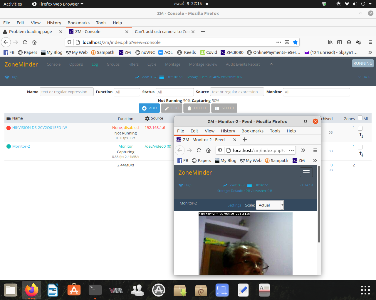

You can add usb camera monitor by editing the codes of Device Format and Palette manually by the procedure suggested by aparajit in the following post for Zoneminder master 1.35.5~20200714143209-focal . Please refer the following link .
I think , the method adopted by Mr Isaac to solve the usb camera problem in Zoneminder master 1.35.5~20200714143209-focal , may be used for Zoneminder -1.34.18-focal1 also
