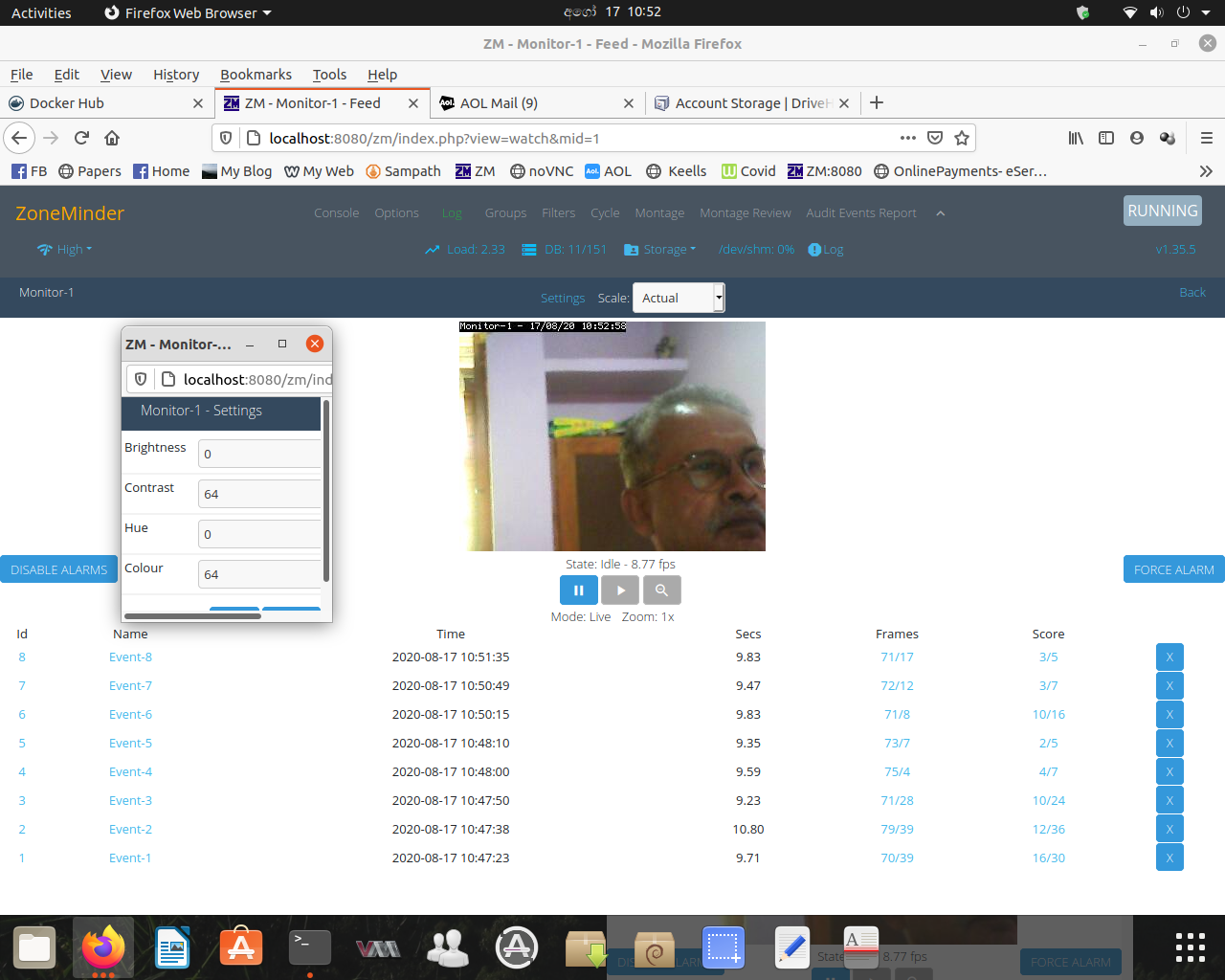

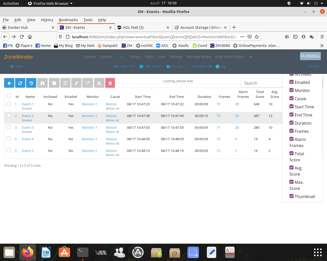

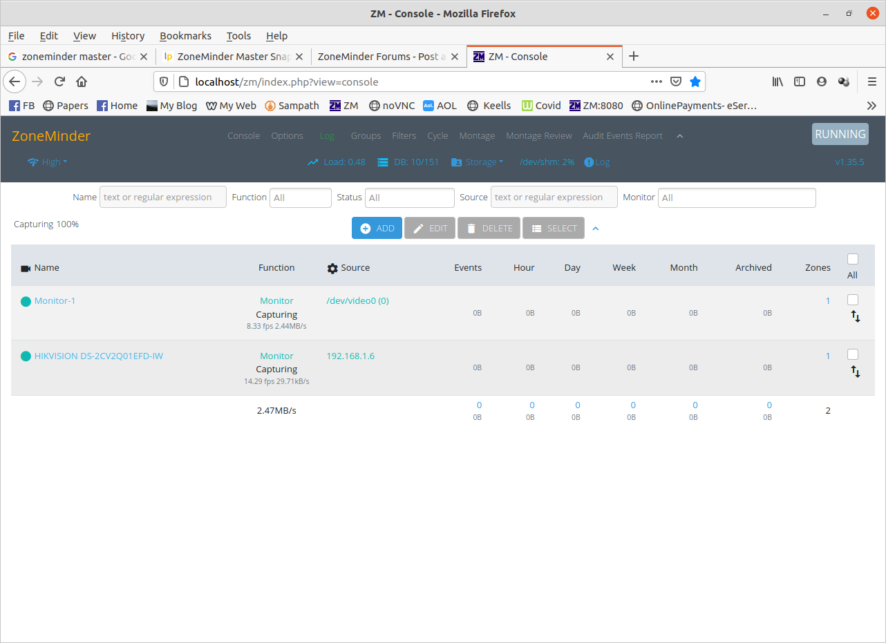

I have tested the latest Zoneminder master 1.35.5~20200816200911-focal issued today with two cameras (, USB camera & Hikvision IP camera ).
1. monitor creation is ok
2. Motion detection events can be viewable . Video creation is OK.
3. E-mailing and uploading events can be done.
4. When you press settings button of the monitor ,the popup window shows camera settings (brightness etc) but still can not be adjusted . But this is not a major issue as the brightness settings can easly be adjusted externally using other software .
Found some useful and nice new menu arrangement .

Couple things -
Events for a given came show the correct events, but the the events in event sequence, not per camera.
The event times and duration are not legible with dark CSS.
