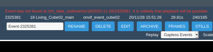

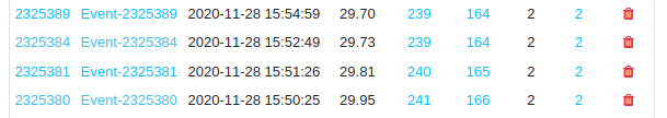

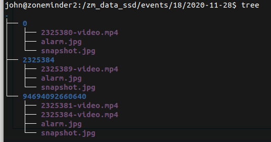

Directories aren't being named correctly in 1.35.14 (Ubuntu PPA).
Either not matching the event ID or being placed in different directories. Really strange! See screenshots attached.
Anyone else experiencing this issue?

I discovered the issue after restoring ZM from backup (due to hardware failure) and updated to the latest ZM version. I was worried it was something to do with the restore, but seems not.
Looks like there were some recent changes to zm_event code https://github.com/ZoneMinder/zoneminde ... 5d44848a26
Posts: 1380
Re: Events not found due to event naming issue
This was fixed today, at least for ubuntu focal.
Posts: 3403
Yeah I screwed up when implementing saving to alternate storage areas if for some reason you can't save to the assigned one.
Fixed.
