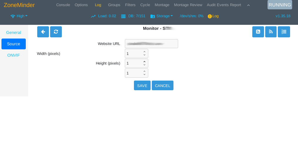

Source Type: Website
Feb 25 21:46:49 devzm web_php[3207]: 02/25/21 21:46:49.552280 web_php[3207].ERR [10.23.2.151] [SQL-ERR 'SQLSTATE[23000]: Integrity constraint violation:
1048 Column 'OutputCodec' cannot be null', statement was 'INSERT INTO `Monitors` (`Id`, `Name`, `Notes`, `ServerId`, `StorageId`, `Type`, `Function`,
`Enabled`, `DecodingEnabled`, `LinkedMonitors`, `Triggers`, `ONVIF_URL`, `ONVIF_Username`, `ONVIF_Password`, `ONVIF_Options`, `Device`, `Channel`,
`Format`, `V4LMultiBuffer`, `V4LCapturesPerFrame`, `Protocol`, `Method`, `Host`, `Port`, `SubPath`, `Path`, `Options`, `User`, `Pass`, `Width`, `Height`,
`Colours`, `Palette`, `Orientation`, `Deinterlacing`, `DecoderHWAccelName`, `DecoderHWAccelDevice`, `SaveJPEGs`, `VideoWriter`, `OutputCodec`, `Encoder`,
`OutputContainer`, `EncoderParameters`, `RecordAudio`, `RTSPDescribe`, `Brightness`, `Contrast`, `Hue`, `Colour`, `EventPrefix`, `LabelFormat`, `LabelX`,
`LabelY`, `LabelSize`, `ImageBufferCount`, `WarmupCount`, `PreEventCount`, `PostEventCount`, `StreamReplayBuffer`, `AlarmFrameCount`, `SectionLength`,
`MinSectionLength`, `FrameSkip`, `MotionFrameSkip`, `AnalysisFPSLimit`, `AnalysisUpdateDelay`, `MaxFPS`, `AlarmMaxFPS`, `FPSReportInterval`,
`RefBlendPerc`, `AlarmRefBlendPerc`, `Controllable`, `ControlId`, `ControlDevice`, `ControlAddress`, `AutoStopTimeout`, `TrackMotion`, `TrackDelay`,
`ReturnLocation`, `ReturnDelay`, `DefaultRate`, `DefaultScale`, `SignalCheckPoints`, `SignalCheckColour`, `WebColour`, `Exif`, `Sequence`, `ZoneCount`,
`Refresh`, `DefaultCodec`, `Latitude`, `Longitude`, `RTSPServer`) VALUES (?, ?, ?, ?, ?, ?, ?, ?, ?, ?, ?, ?, ?, ?, ?, ?, ?, ?, ?, ?, ?, ?, ?, ?, ?, ?,
params:,testwebsite,,0,0,WebSite,Mocord,0,0,,,,,,,,0,0,,1,,raw,,,,http://www.steak.com,,,,640,480,4,0,ROTATE_0,0,,,3,0,,auto,,# Lines
beginning with # are a comment Feb 25 21:46:49 devzm web_php[3207]: # For changing quality, use the crf option Feb 25 21:46:49 devzm web_php[3207]: # 1
is best, 51 is worst quality Feb 25 21:46:49 devzm web_php[3207]: #crf=23 Feb 25 21:46:49 devzm web_php[3207]: ,0,0,-1,-1,-1,-1,Event-,%N - %d/%m/%y
%H:%M:%S,0,0,1,20,0,5,5,0,1,600,10,0,0,,0,,,100,6,6,0,,,,,0,,-1,,100,0,0,#0000BE,#ff0000,0,1,0,,auto,,,0] at
/usr/share/zoneminder/www/includes/database.php line 161 Feb 25 21:46:49 devzm web_php[2970]: 02/25/21 21:46:49.587529 web_js[2970].ERR [10.23.2.151]
[TypeError%3A%20form.elements%5B'newMonitor%5BFunction%5D'%5D%20is%20undefined] at zm/index.php?view=monitor line 1294 Feb 25 21:46:49 devzm
web_php[3207]: 02/25/21 21:46:49.604533 web_php[3207].ERR [10.23.2.151] [Error saving new Monitor.] at
/usr/share/zoneminder/www/includes/actions/monitor.php line 231
Also some slight rendering issues in the browser for the website page. The refresh-timeout label is missing, and width / height are misplaced. Of course, I did test this with relevant height and width (i.e. 640x480). Please ignore the entries of 1 in the screenshot.
