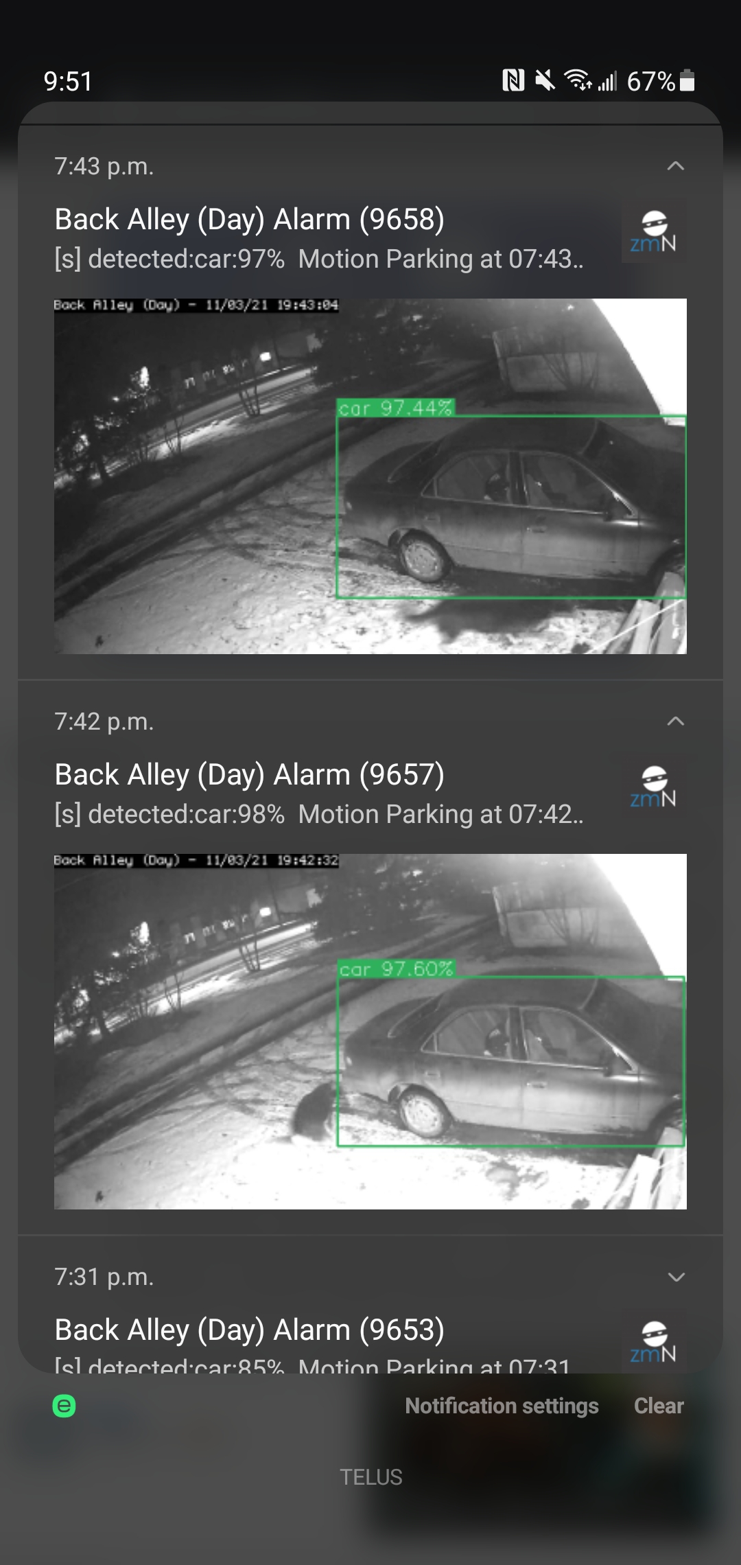

I'm not sure what's going on but it's hit and miss. I've been studying python so I can try and follow the scripts and maybe modify them for this use case. As my screenshot shows I am getting back to back events with same obj detected and need to figure out how to set up logging so I can see what pyzm past detections is doing.![Image]()
- Screenshot_20210311-215133_Chrome.jpg (589.1 KiB) Viewed 7116 times
Re: match_past_detections granularity?
Compare debug logs - pictures won’t help much.
Take a look at debug logs for 9658 and go through all steps and see what matching debug logs state
