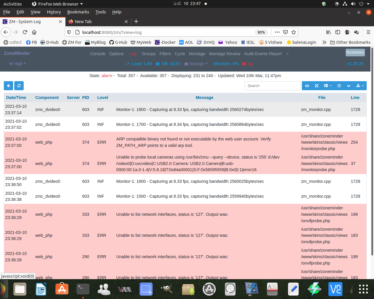

The Zoneminder master 1.35.20~20210309163038-focal released today ,has been tested with a USB camera and Hikvision network ip camera.
It was found that ,only one monitor can be shown in the ZM panel . When the second monitor is added , the first monitor is automatically deleted .
The error log is attached herewith please

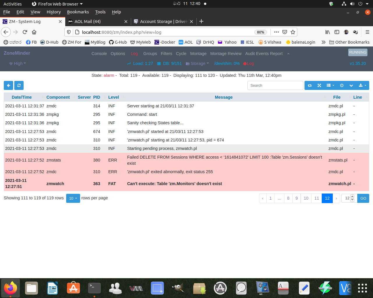

I have tried with the latest zoneminder master 1.35.20~20210311092658-focal latest release also. The problem is still there.
The respective error log is appended below

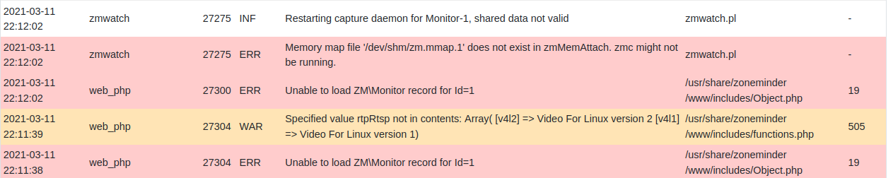

The same problem is there in the latest zoneminder master 1.35.20~20210311131653-focal released today

There are lot of different errors in there. First off the log shows you doing a monitor probe which then tries to use tools like arp to scan the network for cameras. It isn't installed. Also it is complaining about not being able to list network devices. We use the command "ip link" to do this. ip really should be installed.
Next we see errors about your Sessions table not being present.. that was added in 1.35.9. You can fix it by doing:
mysql -u zmuser -p zm < /usr/share/zoneminder/db/zm_update-1.35.9.sql
