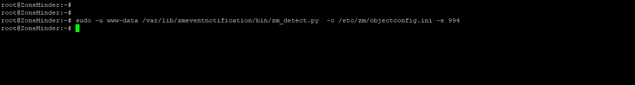

Re: I am lost in the configuration of zmeventnotification
sudo -u www-data /var/lib/zmeventnotification/bin/zm_detect.py  -c /etc/zm/objectconfig.ini -e 24524
Make sure the event number (24524) matches an alarm on your system. What does it do?
Check logs also.
titof2375
Posts: 66
Post by titof2375 »
nothing happens

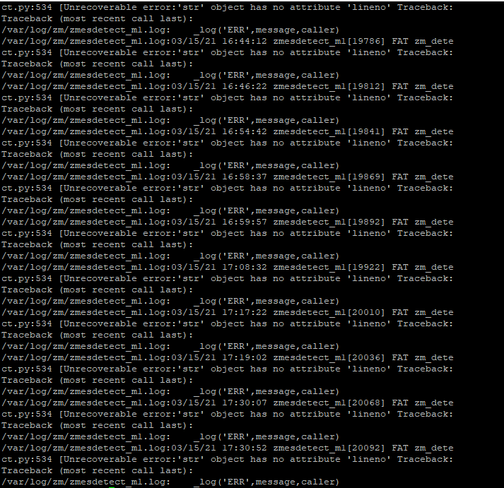

Ok.
And the logs? Should be some zmesdetect***.log.
egrep 'FAT|ERR|WAR' /var/log/zm/zmes*.log

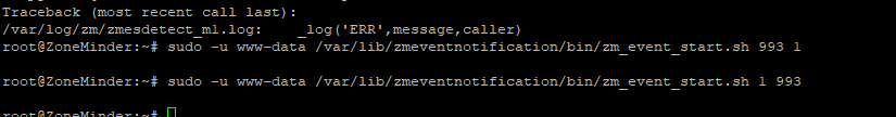

Also please test
sudo -u www-data /var/lib/zmeventnotification/bin/zm_event_start.sh
Add the eventID and MonitorID.
zoneminder erreur1.PNG (65.31 KiB) Viewed 22699 times
Magic919 wrote: Mon Mar 15, 2021 1:20 pm Ok.

Magic919 wrote: Mon Mar 15, 2021 1:30 pm Also please test
zoneminder 5666.PNG (8.09 KiB) Viewed 22699 times

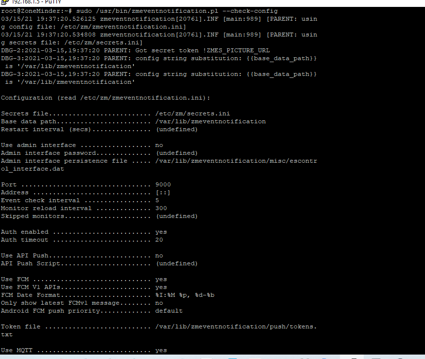

Ok. The FAT error is FATAL, so it won't work.
It's throwing an exception and I'm not clever enough to know why.

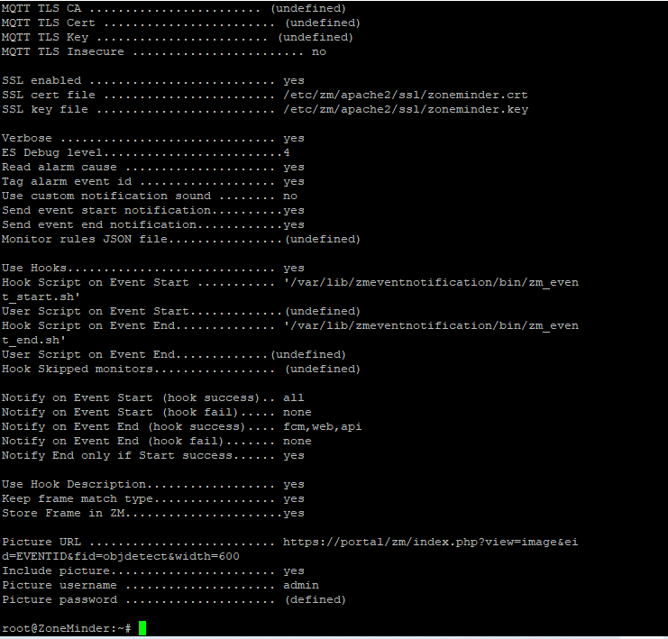

Might be worth testing your config with this.
sudo /usr/bin/zmeventnotification.pl --check-config
The author @asker might appear here if we are lucky.

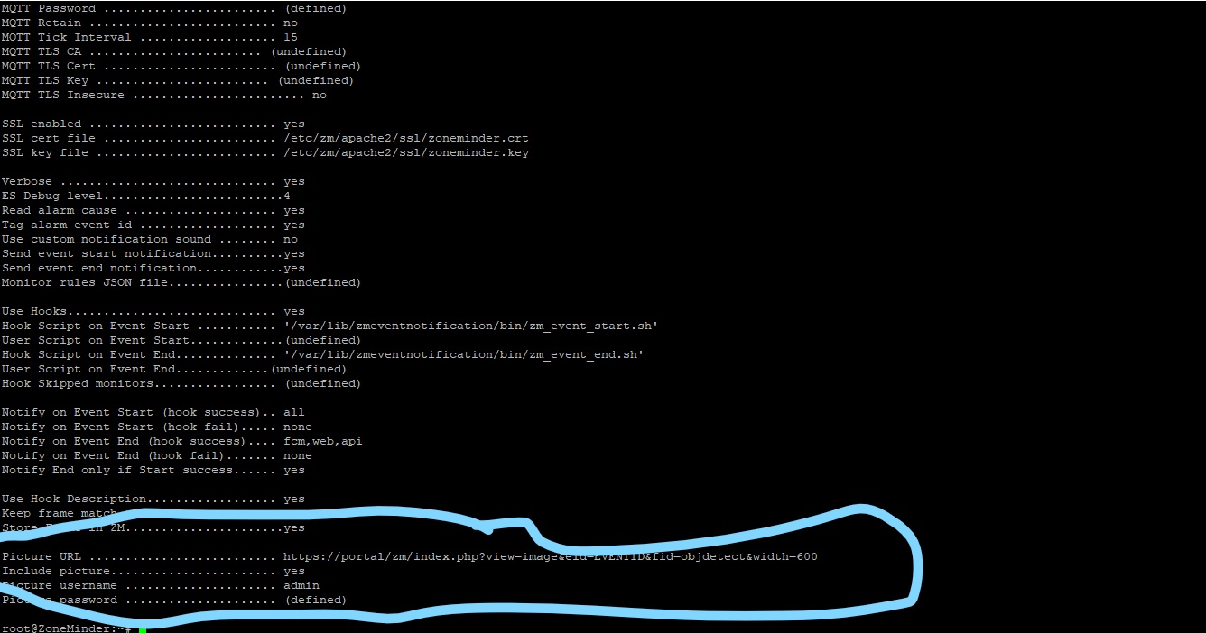

That Picture URL is meant to point to your Zoneminder instance.
titof2375
Posts: 66
Post by titof2375 »
Magic919 wrote: Tue Mar 16, 2021 8:16 am That Picture URL is meant to point to your Zoneminder instance.
hi, are you talking about what's surrounded.
After which it is in which file suddenly?

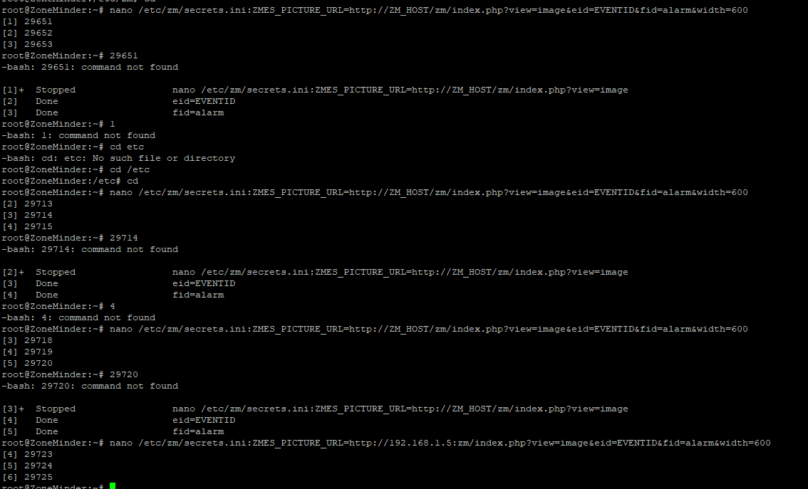

In secrets.ini. It's the first one, but you might as well check the other ones too.
/etc/zm/secrets.ini:ZMES_PICTURE_URL=http://ZM_HOST/zm/index.php?view=image&eid=EVENTID&fid=alarm&width=600
/etc/zm/secrets.ini:ZM_PORTAL=http://ZM_HOST/zm
/etc/zm/secrets.ini:ZM_API_PORTAL=http://ZM_HOST/zm/api
ZM_HOST change to match your server.
titof2375
Posts: 66
Post by titof2375 »
pas compris.PNG (50 KiB) Viewed 22628 times
I don't understand how to do it
