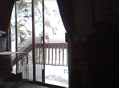

And with that - Ta-Da!
Monitors (6,'Monitor-6',
'',0,0,'Libvlc','Mocord,1,NULL,'','',0,0,NULL,1,'http','rtpRtsp','sg34','81','','http://sg34:81/stream',NULL,NULL,NULL,1 ... ,NULL,NULL,'# Lines beginning with # are a comment \r\n# For changing quality, use the crf option\r\n# 1 is best, 51 is worst quality\r\n#crf=23',0,0,-1,-1,-1,-1,'Event-','%N - %d/%m/%y %H:%M:%S',0,0,1,20,0,5,5,0,1,600,10,0,0,7.00,0,10.00,10.00,100,6,6,0,NULL,NULL,NULL,NULL,0,NULL,-1,NULL,100,100,'auto',0,'#0000BE','#92ab03',0,1,NULL,NULL,NULL,NULL,NULL,NULL,NULL,NULL,NULL,NULL,NULL,NULL,1,NULL);
Key is: Source type: Libvlc, TCP, 24 bit color. and it works. Why nothing else does ...???
Not the best image, no sun, 12" of snow overnight Sat May 21 07:37:47 AM MDT 2022 - Ho, Ho, Ho - Bah, humbug!
Source code: loaded arduino-esp32-master.zip - File - Examples - ESP32 - Camera - CameraWebServer
and added
IPAddress ip(192, 168, 0, 34);
IPAddress gateway(192, 168, 0, 1);
IPAddress subnet(255, 255, 255, 0);
IPAddress DNS(8, 8, 8,
WiFi.config (ip, gateway, subnet);
Amazon: Frienda 2 Pieces ESP32-CAM WiFi Board
Wish I knew more of the internals of ZM. If I haven't answered everything ...
