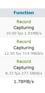

i have 3 identical Cameras (Reolink RLC-520).
Same config.
Same config on ZM 1.32.3 (debian Buster).
The first is locked at 10fps, the second at 25 and the third at 8.
Where comes the difference in kB/s from?
Why does the first Cam produces twice as much at 10fps, as the 2nd on 12fps?
Tia
Jay

Magic919 wrote: Mon May 10, 2021 12:21 pm I don't think I understand the question.
Is there a better picture with 10mbit?
The fps and resolution is the same.

dougmccrary wrote: Tue May 11, 2021 12:57 am If you switch the settings to another one of the three cameras, is the result similar?
Also, are the cams seeing similar scenes in terms of motion?
Cam 1 and Cam 2 sees the same Scene from different Directions.
Re: strange datarate on record
Posted: Tue May 11, 2021 5:59 am
by dougmccrary
OK. So if you reverse the setting of cam1 and 2, does FPS and datarate follow the same pattern? I'm wondering if they are really identical.
