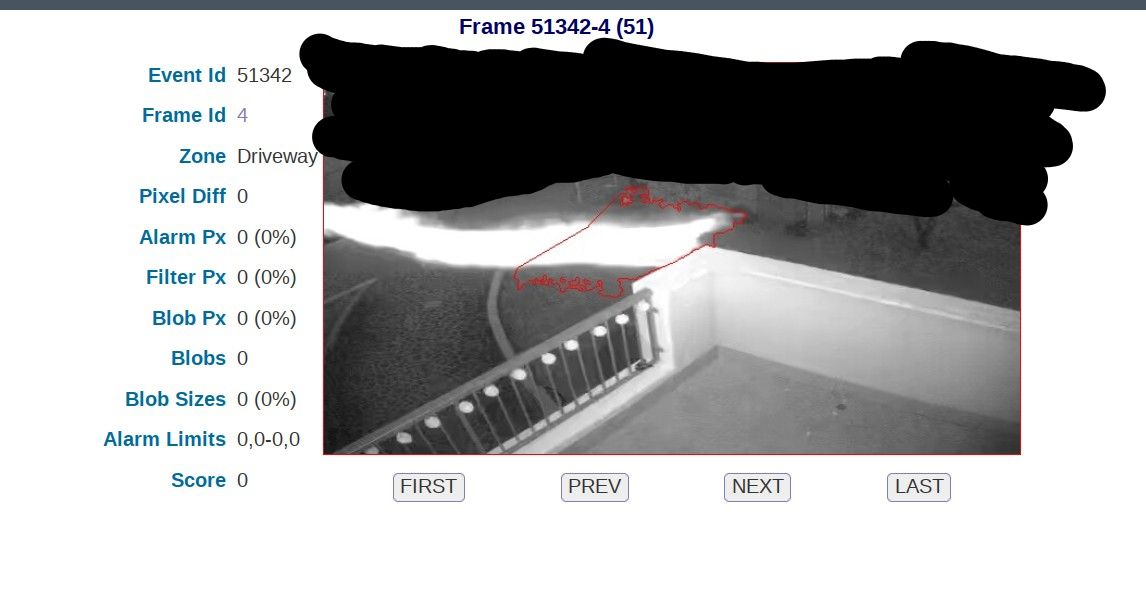

I am trying to tune the motion-detection but I often get no statistics or bad numbers.
Sometime N/A or 0. Some times I do get reasonable numbers but I remain unsure if they are really for the frame I see.
Attaching an example.

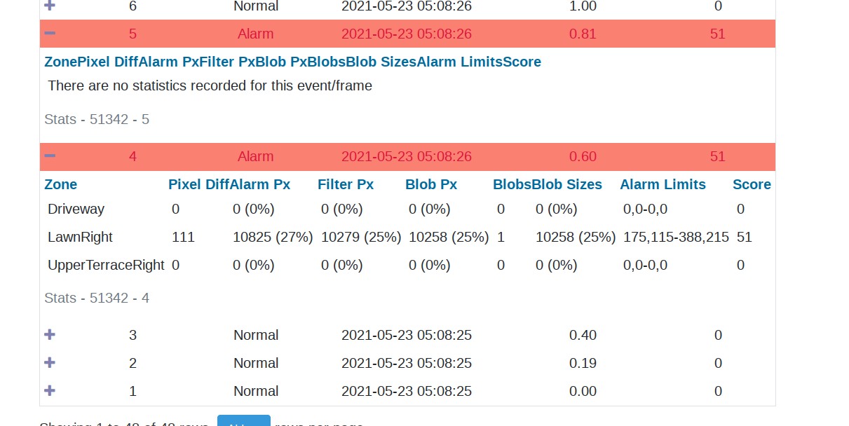

When looking at the "frames view" I can see other statistics.
So there seems to be a problem with more than one zone?
Sigge
Posts: 116
Joined: Mon May 02, 2016 8:14 am
Re: No statistics for alarmed frames
Post by Sigge »
Ok, figured it out by wring this post... Zoneminder told me all along.
The statistics do not belong to the zone that has the alarm. But the graphics do.
Is it supposed to work like that?

It's entirely possible that there is a problem. There were problems and I fixed them but maybe I don't have them all.
stats should be correctly correlated and listed for each zone.
