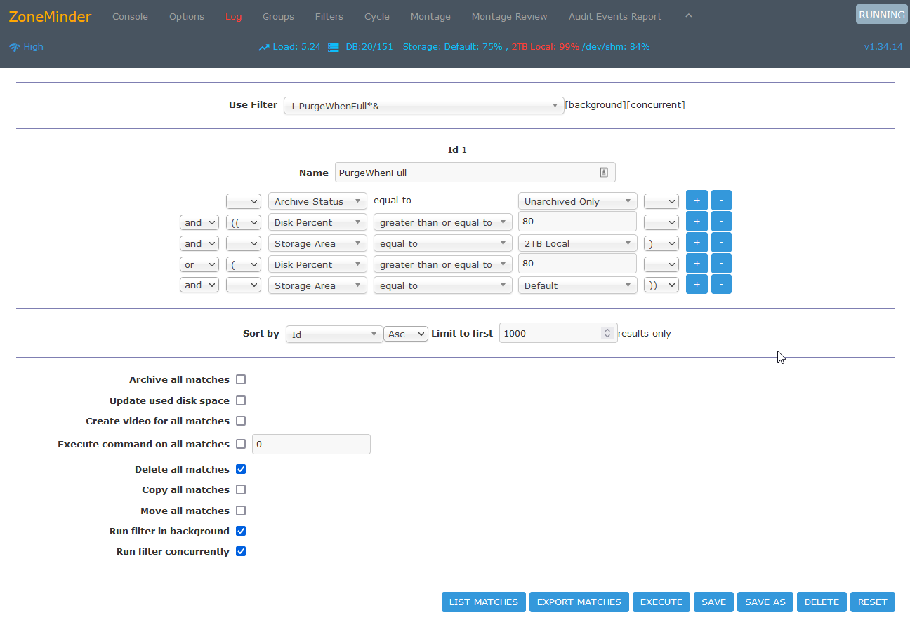

I have this filter (see attachment below) setup. It does Not run automatically. Every few days I have to manually click Execute and then manually click the checkbox to select all and scroll down and click Delete.
Why won't it run and delete automatically?
Thanks!

I've divided it up into 2 filters, one for Default storage and one for 2TB storage. I'll see how that goes and report back.
@Magic919 As for having multiple storage locations, that's a non-issue. Simply set in the camera Storage tab settings which one to use.
kyferez
Posts: 21
Joined: Fri Dec 25, 2020 7:13 pm
Re: Filter does not run automatically on it's own like it should
Post by kyferez »
Well it does look like it is working now. There must be some bug with the more complex expressions.
