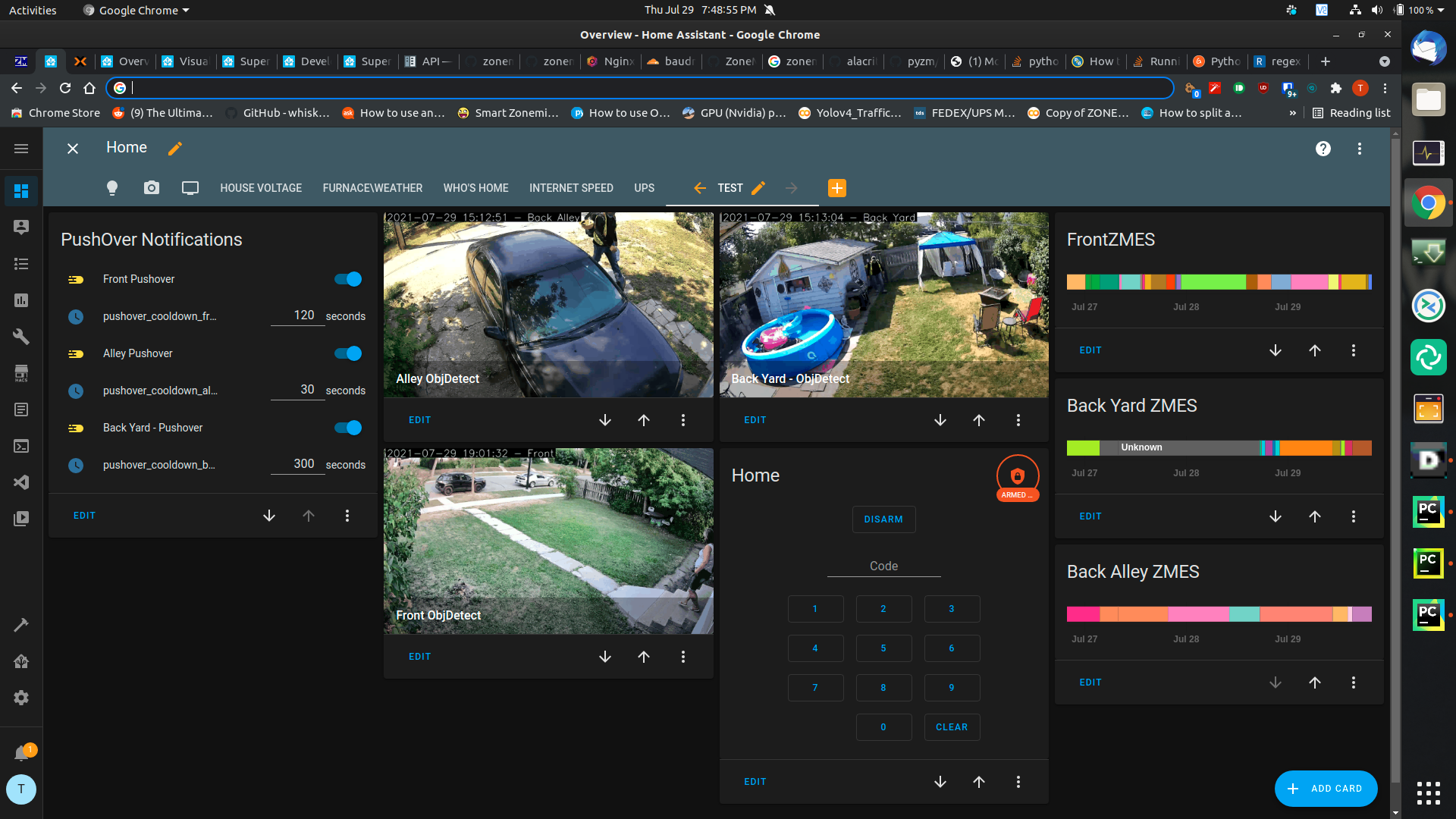

The zone switcher script (module if daemonized) is almost done as well I just don't have a use case for it at the moment So i can't test it out thoroughly. I am unsure if it should be a standalone script for a cron job or to daemonize it and let it compare times every x seconds/minutes.
Most of the other stuff is ready as well i'm just figuring out how to roll it all out and get it installed. It is very different from the core code and I added and moved a lot of things into pyzm. So it would be a forked pyzm install, forked mlapi and forkled zmeventnotification needed to run in a venv or however you set up your python env. For now its going to be a python3 and zm 1.34+ minimum and there may be a cpl more dependencies to download.
I have added a python based USB port resetting tool for the USB TPU delegate error but haven't been able to test it out or automate a USB port reset when its actually needed yet.
Some log output ->

Here is a screenshot of HA for the general idea on the pushover sensors and also the MQTT camera entities. They accept JPG and GIF.
Screenshot from 2021-07-29 19-48-55.png (966.87 KiB) Viewed 37295 times
