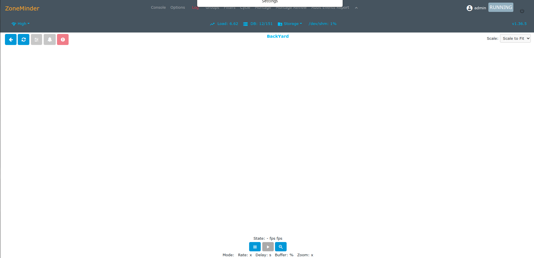

i finally got some of my cameras connected in Monitor mode.
The question I have is how do you view them?

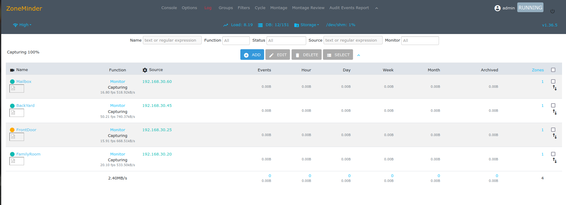

"A picture is worth a thousand words" :-)
Check out system load: 8.19 seems very high. Probably you simply don't have enough compute power.
Check out reported frame rate: assuming you have similarly set cameras FPS should be nearly identical, but you got them between 15-60. Again, CPU seems weak.
You got 2.40MB/s overall bitrate for 4 cameras. I got 3.2MB/s for 27 cameras and my system load is always around 2.
Performance and stability relies on the ammount of RAM too.
So first of all set all your cams disable but one. Adjust resolution and frame rate using camera's own gui, not ZM. Start with 1280x720@15fps, that should work. Slightly increase workload until you reach the limits of your system.

@vrm42z Actually, the CPU stats are misleading. My ZoneMinder is one LXC container of 30 running on this host. The host is 25% loaded, but the CPU stats are for all 30 containers and not just for Zoneminder.
So, Zoneminder has tons of available resources in reality. My problem if I had to guess is that there is something missing that causes cameras to be able to be displayed and after reading all over the net, I am just starting to believe that Zoneminder supports an extremely limited set of cameras and Reolink cameras are not in that set.

I still think you're on the wrong foot. ZM doesn't work fine or at all at minimal resources. Your sreenshot tells heavy load. I run ZM on a vm on esxi (big ass ryzen cpu, system on nvme, 16GB dedicated RAM). There are 7 other vms running, but ZM's vm load is around 2 with 8 vcpus (esxi reports 40% cpu load).

To answer your fundamental question, though, use Montage Review to look at your cameras/monitors.
And consider whether you need to use the full capabilities of the cameras. Mine are 4MP, but I run them at 720p/6fps, and it works out just fine for us.
