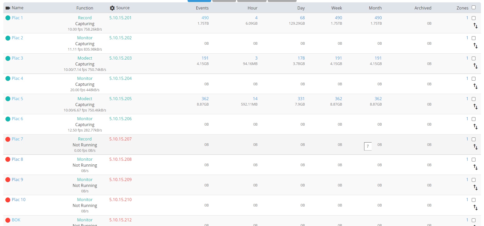

I have an issue that I couldn't solve.
As you can see in the image enclosed only 6 cameras goes online. I found only topics about problems with "Montage" viev of more than 6 cameras but in my case 7th camera simply doesnt go online. If I make one of those working offline, another one for example "Plac7" goes online but not more than 6 devices in one time.
Looks like limit of online devices? Something wrong in config?
Best regards!

- Bez tytułu.jpg (185.68 KiB) Viewed 2716 times
Re: Online devices limit
Montage viewing of 6 cameras is an unrelated issue. That is only for a client viewing the cameras, not the recording of them. What are your system specs? This scenario looks like you don't have enough CPU / RAM to run 7 cameras. Is this an ARM board? If that is the case, you can try lowering the FPS / resolution on the cameras, or upgrading the hardware.
