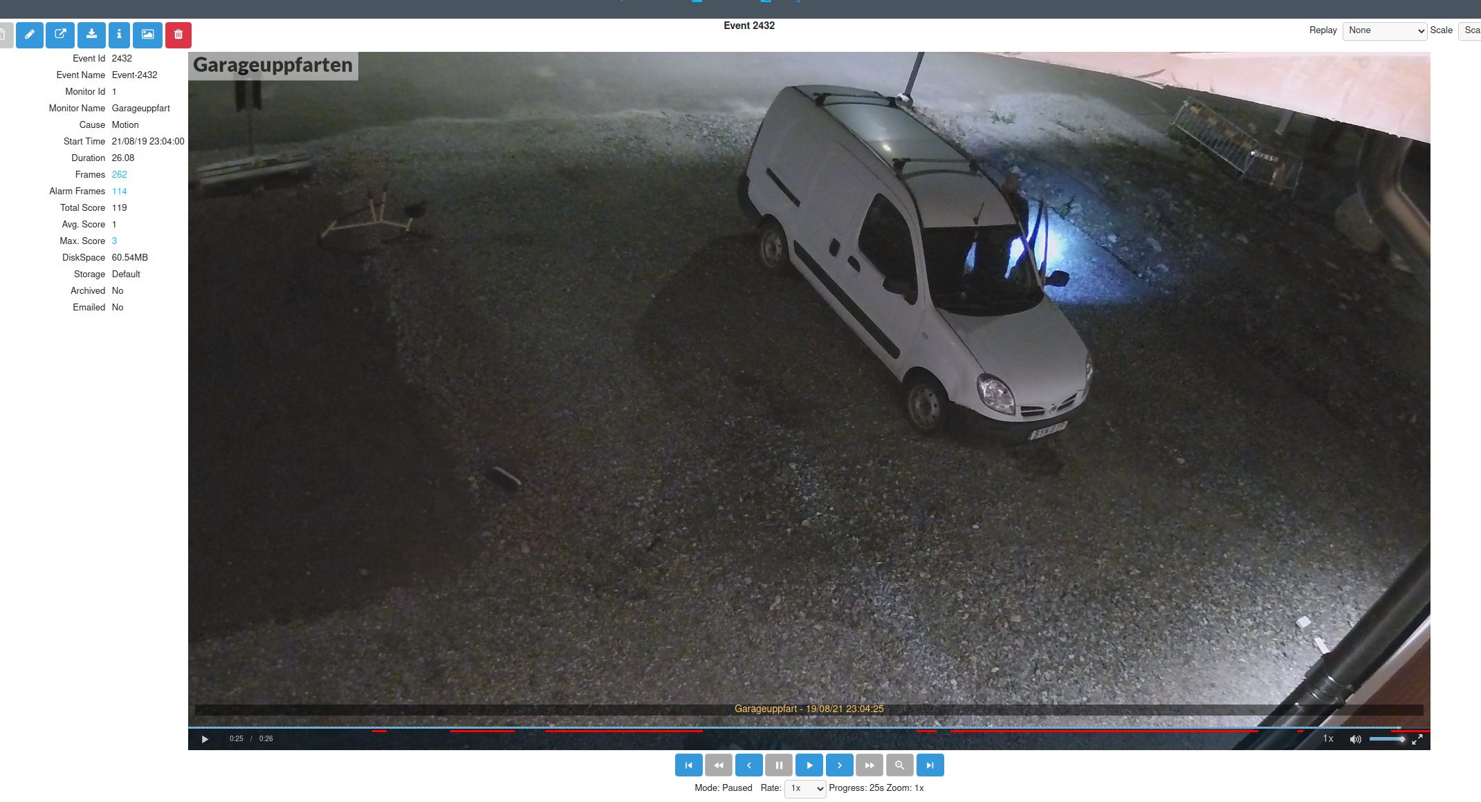

Just trying out Zoneminder as a replacement for the now discontinued Unifi Video. Everything seems to work fine, except that some events, sometimes just breaks in the middle of a recording (and the next minute of the event is lost).
Here is an example:
As you can see in the screenshot, the video is still in an alarm state, when it suddenly stops.
Here is the log for this particular event:

Posts: 3362
Re: Event/recording breaks with: "zmwatch: Restarting capture daemon xxxxx"
Honestly looks like a bug to me.
zmwatch is a watchdog that looks for locked up processes and restarts them. It defaults to 45 seconds, but you can change this in options->System->WATCH_MAX_DELAY
We can clearly see in your logs that zmc is responding and doing things less than 45 seconds ago.
So I am tempted to tell you for now to increase that 45 to something significantly larger and I will have to think about what is going on.
Another thing to do is turn on debug logging.
