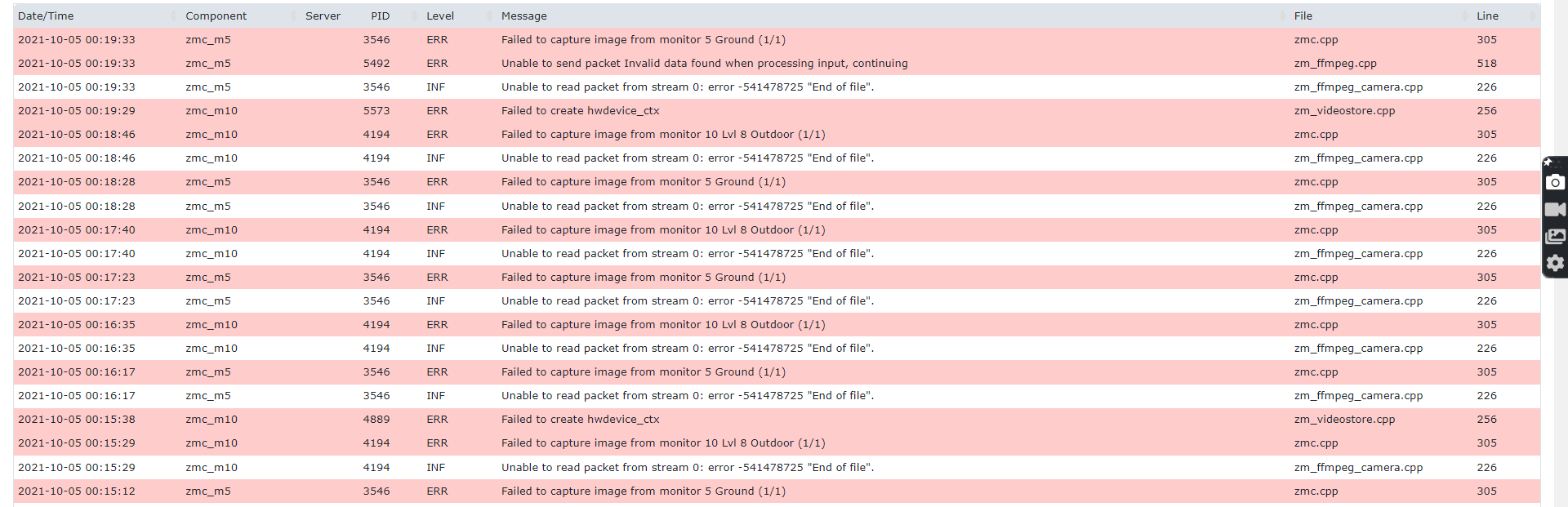

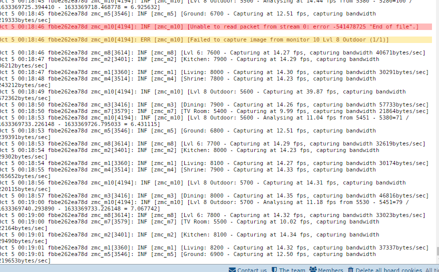

Hello , I have a total of 8 camera and all of them is able to display video. However, i have 2 camera that keep occuring end of file error.

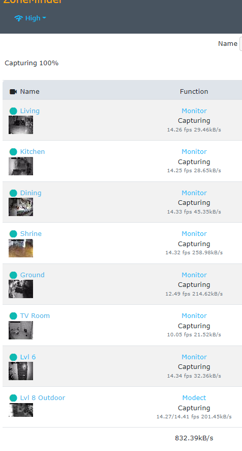

if we look at console, all camera is online. But only these 2 camera is showing error every minutes and image is on and off for a few seconds.
is it because the camera is streaming at 2560x1440 resolution? it happens that these 2 camera are streaming at this resolution while other camera are streaming at 1080.

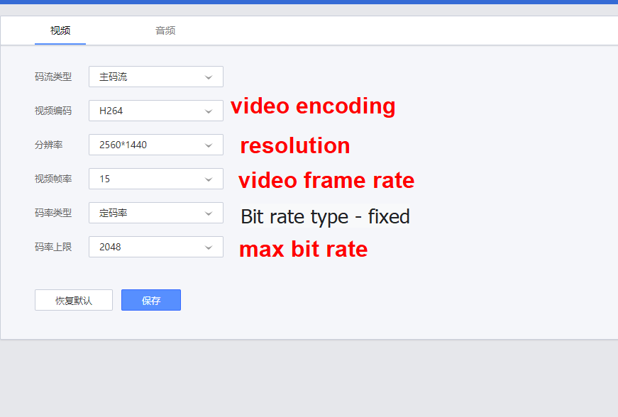

i could not change the resolution.
it is fixed at 2560x1440.
attached is my camera setting ( translated in english )

Does cam have a secondary stream - can you use that?

Maybe also try reducing the framerates, which seem to vary quite a lot.
