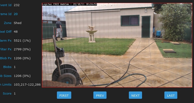

Ok, done a lap, examined each frame of the event.
Really quite interesting where ZM thinks the blob is. I would have thought it would detect me, but for some reason, it's detecting me where I was?
In later frames, it only detects my shirt, not pants, shoes or head or even patches of shed where I was.

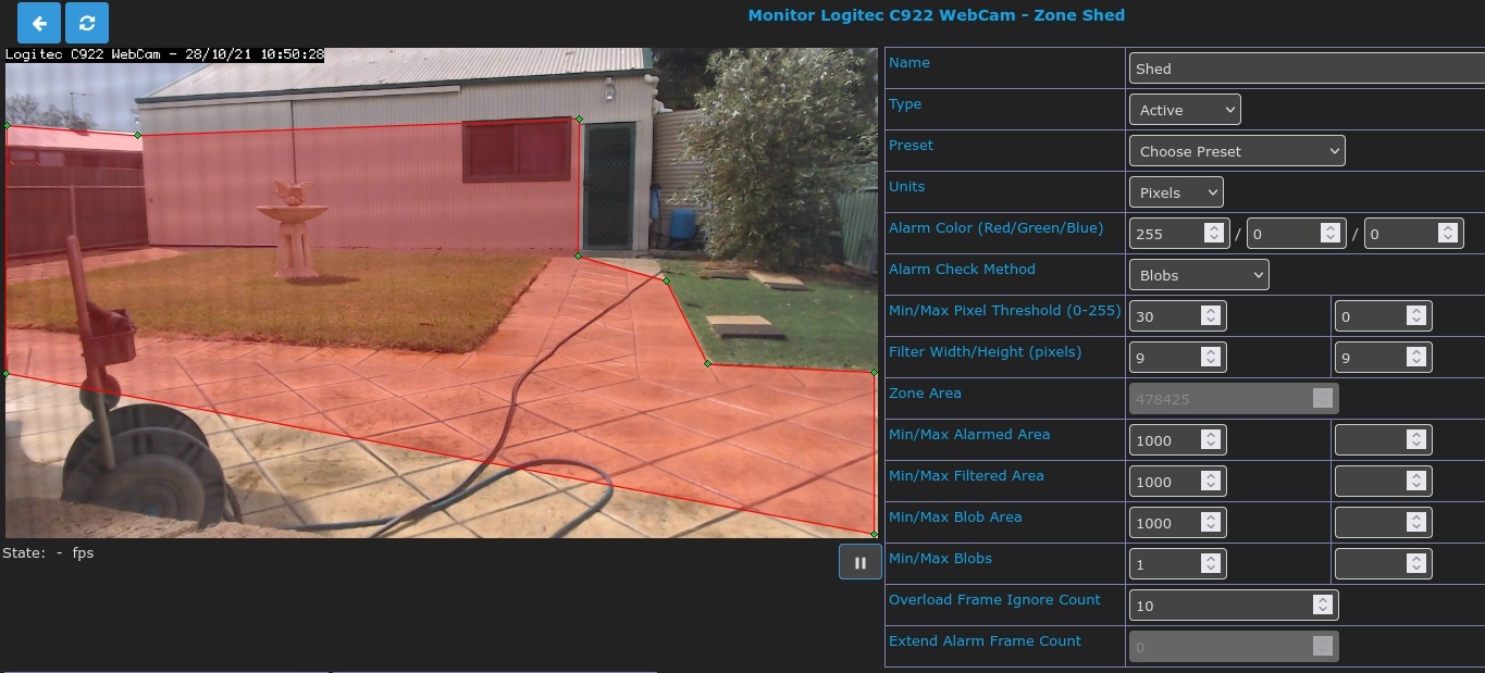

My zone configuration is as follows As an aside, I have events which have been triggered by lightning, I thought I had that covered by Overload frame count. 10 frames should do on a 30fps capture?
...Lyall
