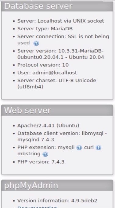

I don't know if it is still needed, see my server config pic for current software versions
