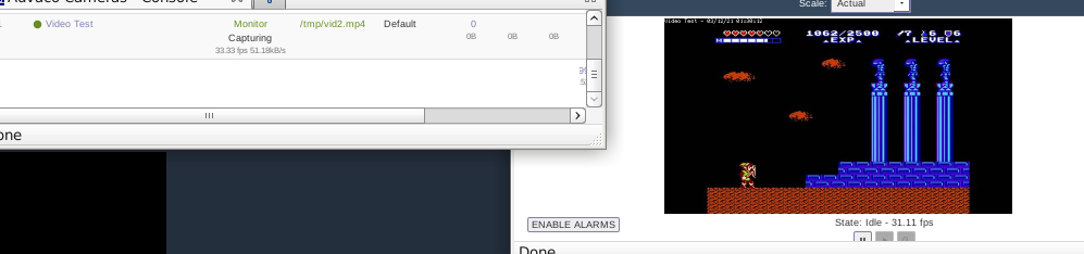

OK, I finally got this working as a monitor, and I copied the zone from the original monitor exactly, but it's not creating alarms. I suspect the reason is the frame rate on the video file monitor is much lower than the actual camera.
On the original camera I get State: Idle - 4fps 3.63 fps 3.63 fps
On the replay-test monitor I get State: Idle - 0 fps 3.58fps 3.44 fps (sometimes 1fps)
The frame rate on the replay-test monitor is visibly slow and seems to freeze up a lot. I don't think it's a server load issue because that hasn't changed and I'm able to view the original camera at its natural frame rate in another window. Maybe the fps of the original camera is too low, or I need to change a setting for ffmpeg?
